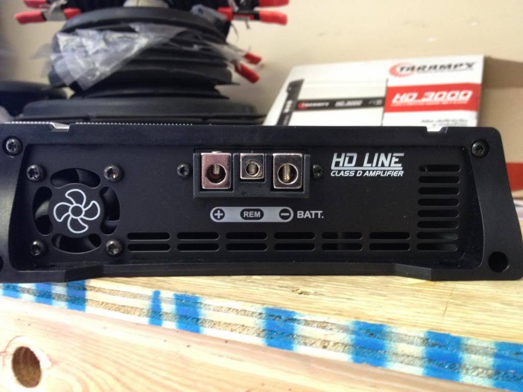

These are conservative 4awg power and ground. How do they do it!? The Cadence wire I used fit in there fine, but you'll play hell getting anything oversized in there. Obviously has a fan too.

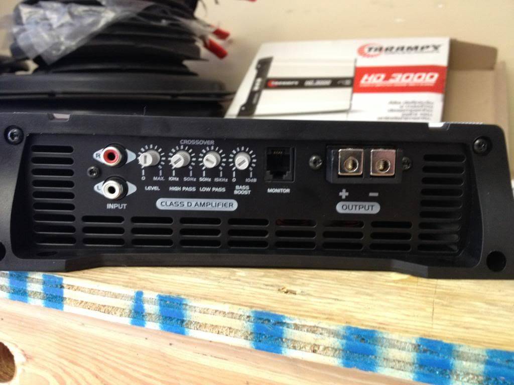

Remember when I said it comes with a single hex key? Well... that's all you need. The same wrench fits every terminal and I would like to take this time to personally thank Taramps for that. Is that so hard to do!? Hellloooo, Korea? Are you listening? Same size ****!
8awg speaker terminals. Single pair. Clean. All good. The pots can be adjusted by hand. That's nice sometimes. They were pretty difficult to adjust, but I imagine that's from them being brand new. Subsonic is the "HPF" but it isn't marked that way. I guess you have to figure that out on your own. That "monitor" port is for a remote LED box that's basically a dash mounted version of the status lights on top of the amp. Power, protection and clipping. Apparently that's sold separately because mine didn't come with one. There's no gain knob on the "monitor" and I can't tell you if it's any more accurate than the ones that come with some Korean amps, but still cool to have, I guess.

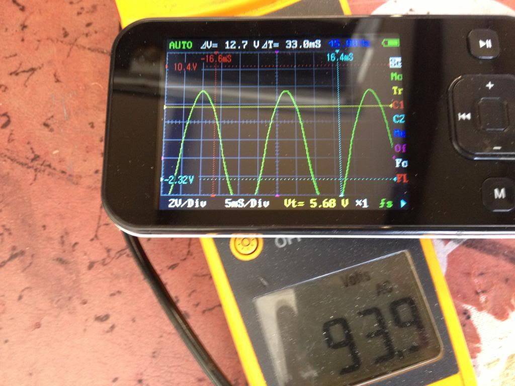

94v clean. That's very promising.

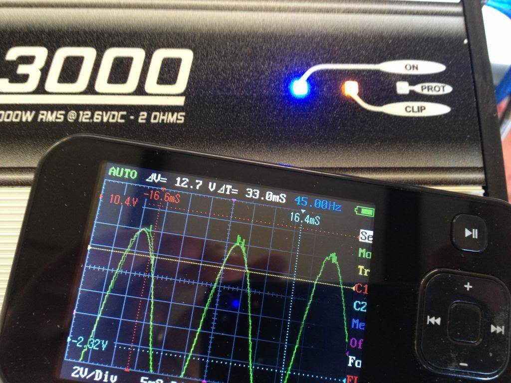

Here's the status lights I was talking about. I ran it into clipping just to see when/if the light came on. Pretty nifty for setting the amp. Fuzzy wave... pretty light. And this is handy because you can't set a Brazilian with the square root DMM method because they make a ton of voltage. Something about half bridge vs. full bridge or some ****. If you used the DMM method, you'd wind up at 77v and leaving a ton of power on the table.
