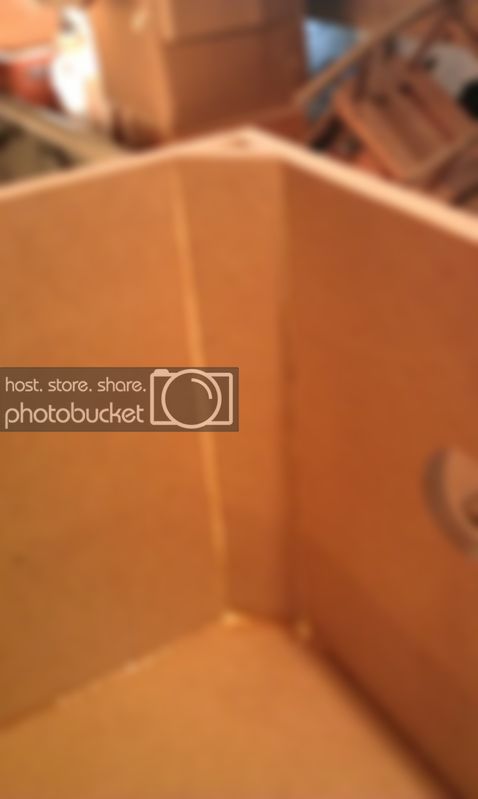

If you look close in that pic you will see where the staples are. 3 per side...I used a clamp to put them in place then staple them in.
