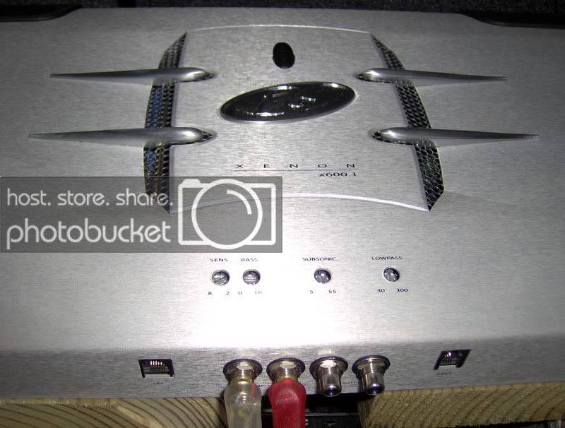

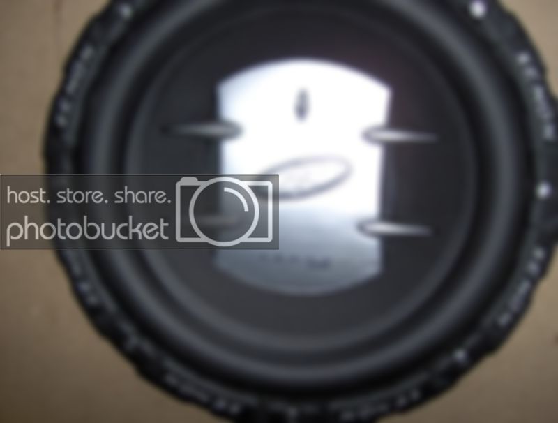

Well, as asked for, some pics of my test setup:

Looks like you got some pretty good excursion goin on there //content.invisioncic.com/y282845/emoticons/smile.gif.1ebc41e1811405b213edfc4622c41e27.gif
Did you attempt to fiberglass the top part of the box? Lol, I'm sorry but you need to get that thing carpeted :p
