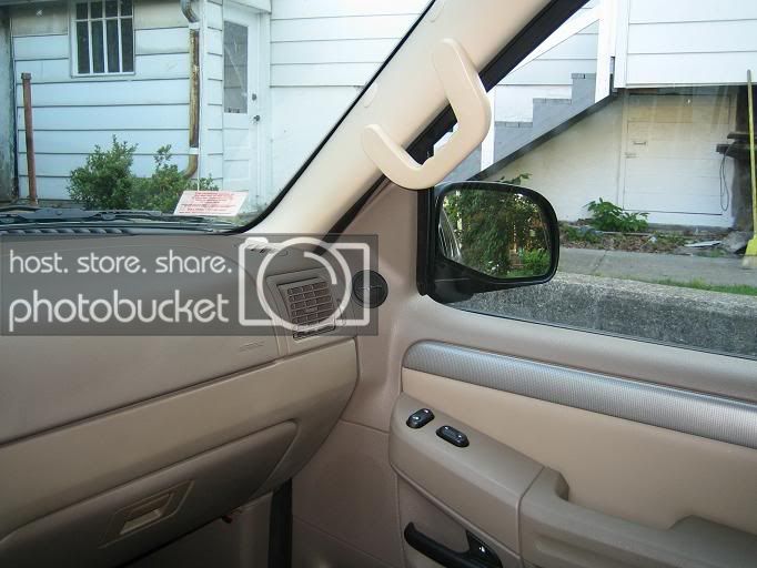

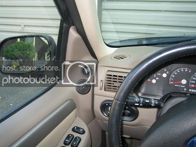

Would it be bad to mount the tweet in this spot?
bamaboy
War Eagle!!!
just wondering since this is the same vehicle as mine, just thinking on where i could mount a tweet
do you have time alignment or can you delay em etc. ?
Good question.
Without some sort of processing there your imaging is going to be, well, nonexistant for the most part. You'd have the output from the left tweet screaming into your ear and the output from the right tweet all but inaudible without something to take up the slack there //content.invisioncic.com/y282845/emoticons/crap.gif.7f4dd41e3e9b23fbd170a1ee6f65cecc.gif
I'm about to get installing in my girls '94 explorer and I'm facing the same questions. I've decided to take off the a-pillar and glass pods for the tweet facing opposite sides, depending on how they sound...
So long as its a soft dome (on axis) type tweeter & aimed at you I dont see a problem. I dont see the doors opening & closing a problem either. Its not like your driving around with your doors open anyway.
the tweet is going to be hard material probably boston pro set, HU has no time align ment or anything like that
Id consider mounting somewere else then. Hard meterial tweets (Off axis) aimed directly at you will be way too bright. I would definetly have them pointed away, like the windsheild center.
Get double sided tape, or velcro, and temporally mount the tweeter, and choose which location you like your tweeter at. Thats the best solution.
