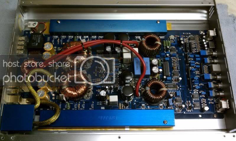

Wondering if this is repairable/ worth getting repaired. Still powers on and plays just fine. Bought a used amp and I know I should have opened it up first.
my powerbass amp is similar, has a few resistors overheated but it still works just fine. i think it may be contributing to the backfeed i got from it
Anyone know what I need to buy? I stole this picture it was the best I could find of what it's suppose to look like.
Looks like all I need is a 223J63 Google seems to bring it up as a capacitor. It's a small rectangular box on the board. The resistors seem fine. I was able to wipe most of the black off. Board looks ok. Maybe some solder came off on other side. Haven't pulled the board from frame yet.
Looks like a mirror image on the opposite side of the board..you should be able to get te part #s from the other side of the burnt ones to be replaced and back up and running
