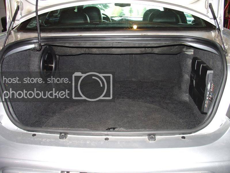

I got my main inspiration from this guy over at the 300M club:
Here is the original thread:
http://300mclub.org/forums/viewtopic.php?t=17531&postdays=0&postorder=asc&start=0
And here is what it looked like finished:
I just hope I can get mine to look that good.

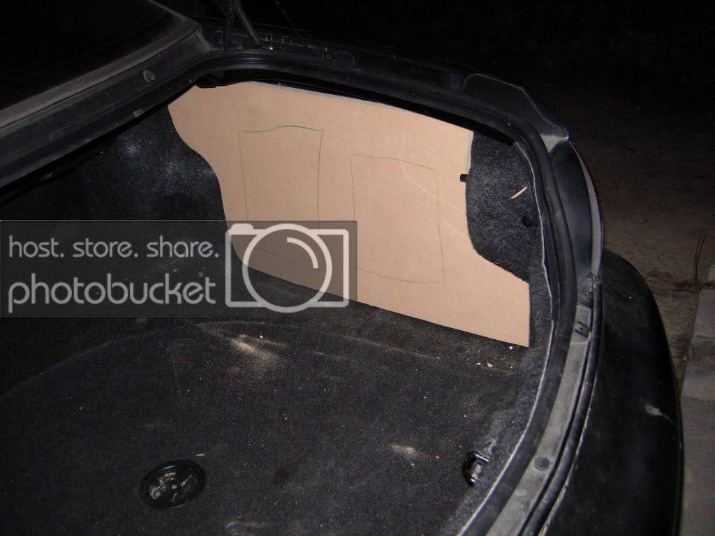

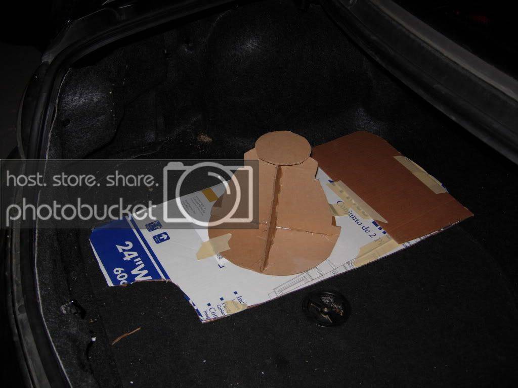

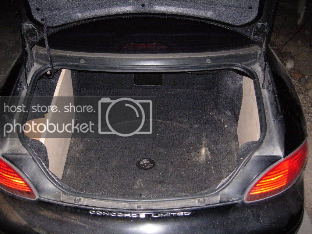

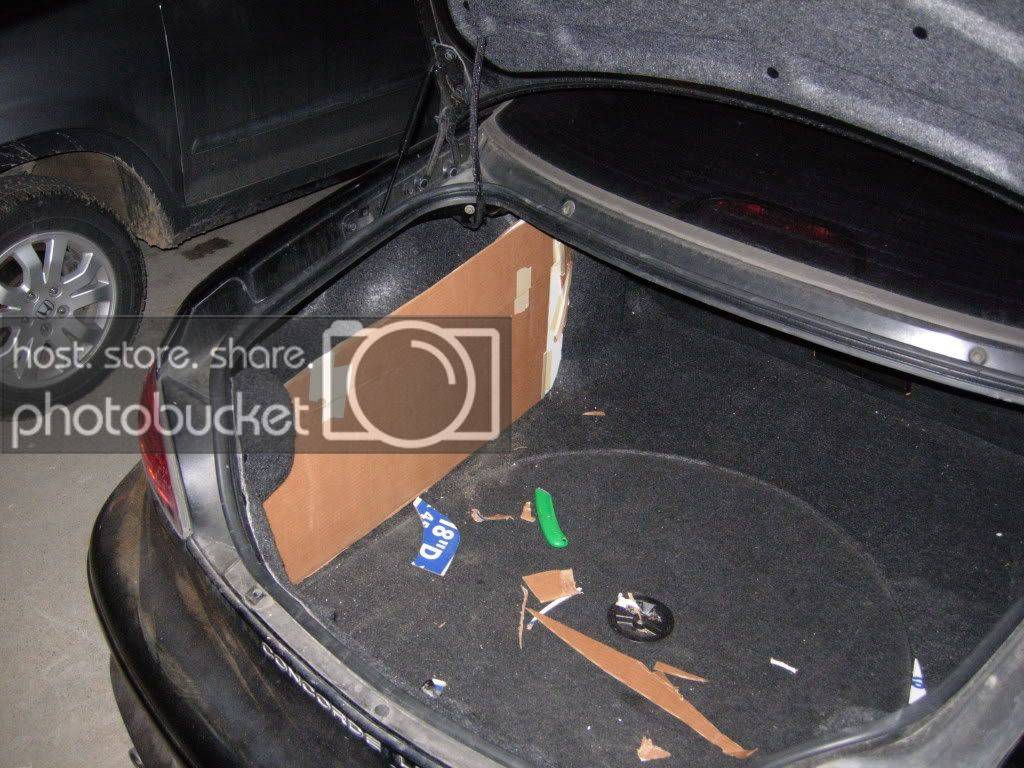

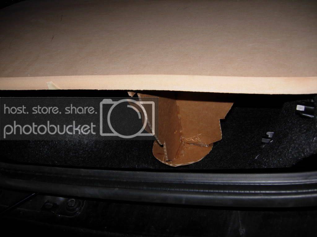

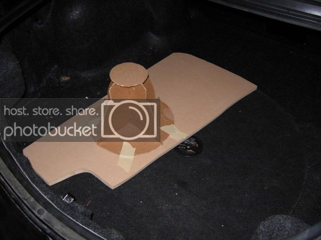

I just got it started today. First i made a mock up of the 12" alpine type R that I'm getting, then started mocking up the MDF walls with cardboard.

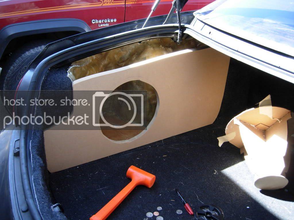

Once i got all the shapes how i wanted them, i went ahead and cut out the MDF for the walls. I made them a bit on the big side, so i could fine tune them and have a nice perfect fit for the panels. It was a bit tricky to cut get them to fit just how i wanted them. I'd say it was about two hours of cutting and trying, then cutting again. They still aren't perfect, but I think it will be just fine once they get carpeted. I might mess with them a little bit more with a hand rasp.

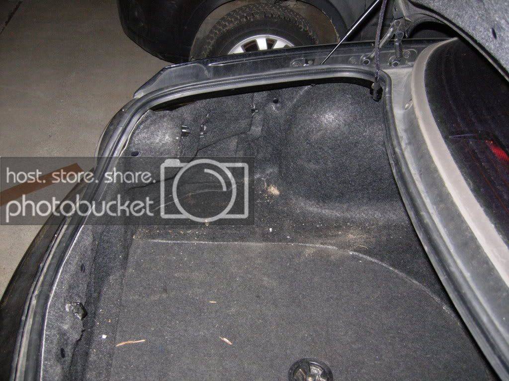

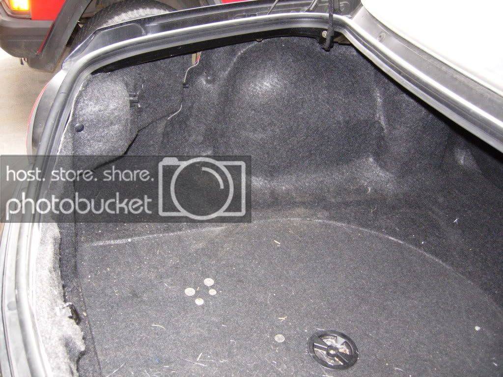

Before:
The sub side cardboard mockup:
And then The MDF:

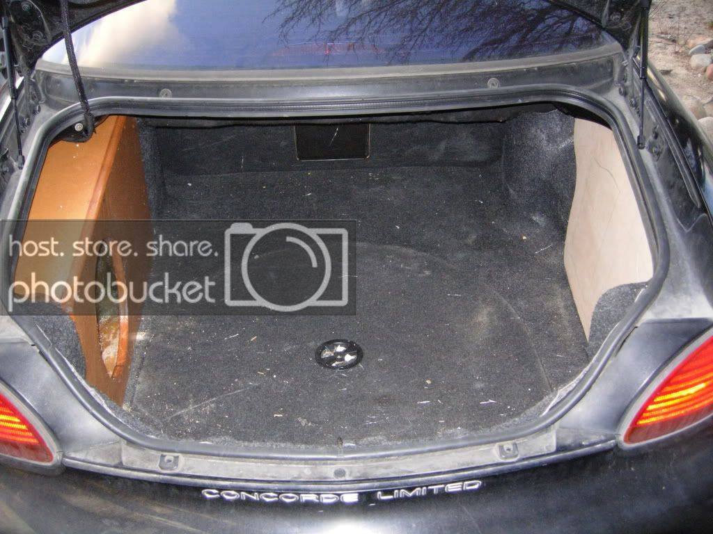

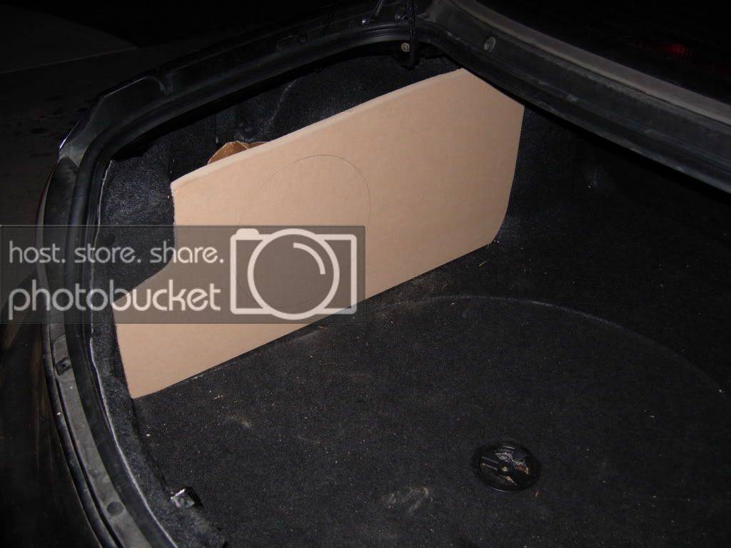

Yeah it Fits back there:
The amp side:
The whole thing:

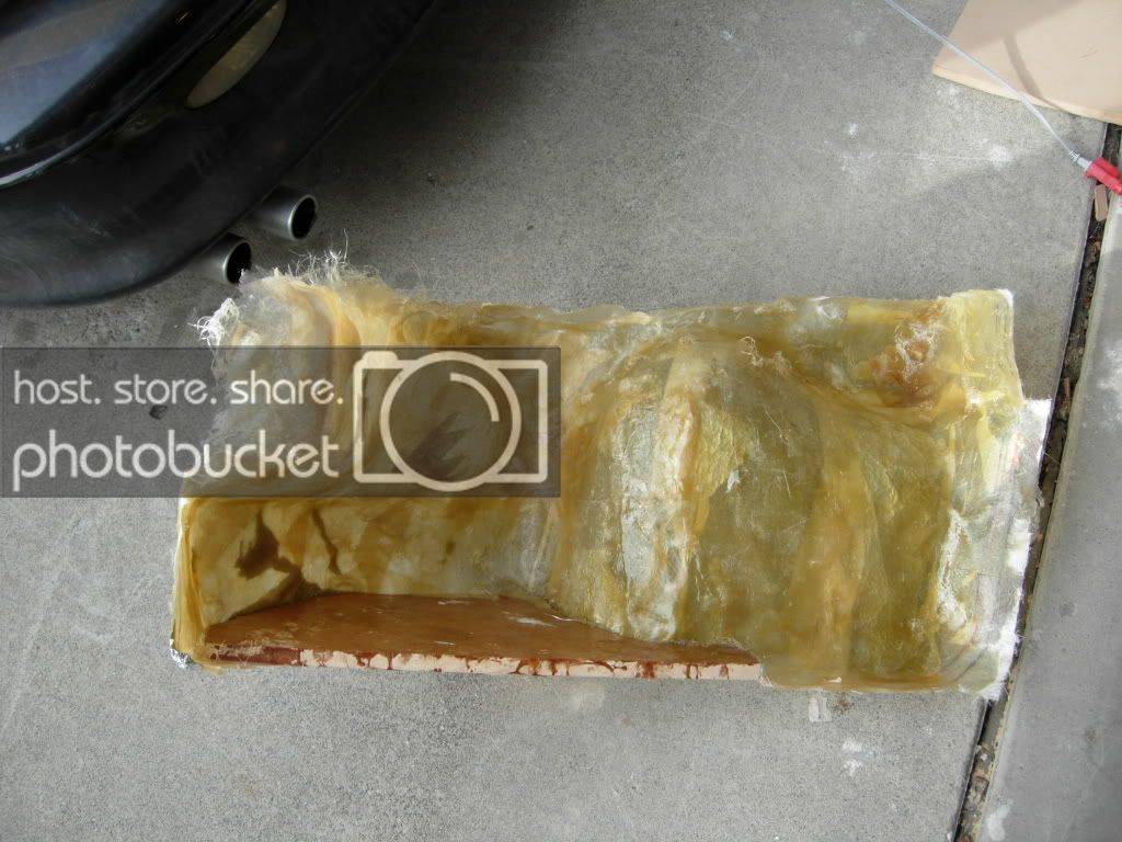

Alright, I've worked my butt off this weekend on this project... about 6 hours on Saturday, and another 8 on Sunday, putting my total up at around 20 hours this far.
I may have lost some brain cells, and my arms itch, and I have resin boogers I'm pretty sure, but I think the end result was worth all the trouble... Although I definitely don't look forward to doing another FG project anytime soon.
Here is a top ten list of tips for people thinking about trying this type of projects:
0. Double your budget. I was really convinced that I would have this thing built for well under a hundred bucks, I ended up spending up towards 200 for it.
1. You didn’t buy enough resin... go buy some more. I ended up using a full gallon, plus 2 small cans.
2. Make sure you get plenty of mat and/ or cloth. I bought 4 packs of mat and 1 pack of cloth. I recommend using the fabric for the first layer, as its a bit easier to work with, then use mat for the rest.
3. People will probably disagree with me on this, but cut up your mat with scissors before you start, into various, fairly small pieces. I tried ripping it as was recommended and it was a lot harder to deal with.

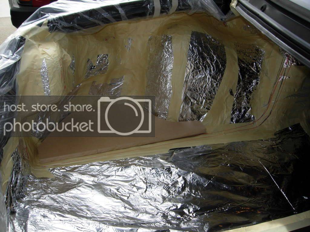

4. Plan to spend an hour or two just on prep, and make sure you cover the body of your car like I did, because resin got on my arms, then I was leaning on the car, I would have got resin on the paint if I didn't cover it.
5. Learn the stabbing/dabbing action with a stiff paintbrush early, that’s how you get rid of bubbles and make it nice.
6. I bought a resin roller, and really liked it for the first layer, and it was useless after that, whether it was worth the 15$ or not is still debatable.

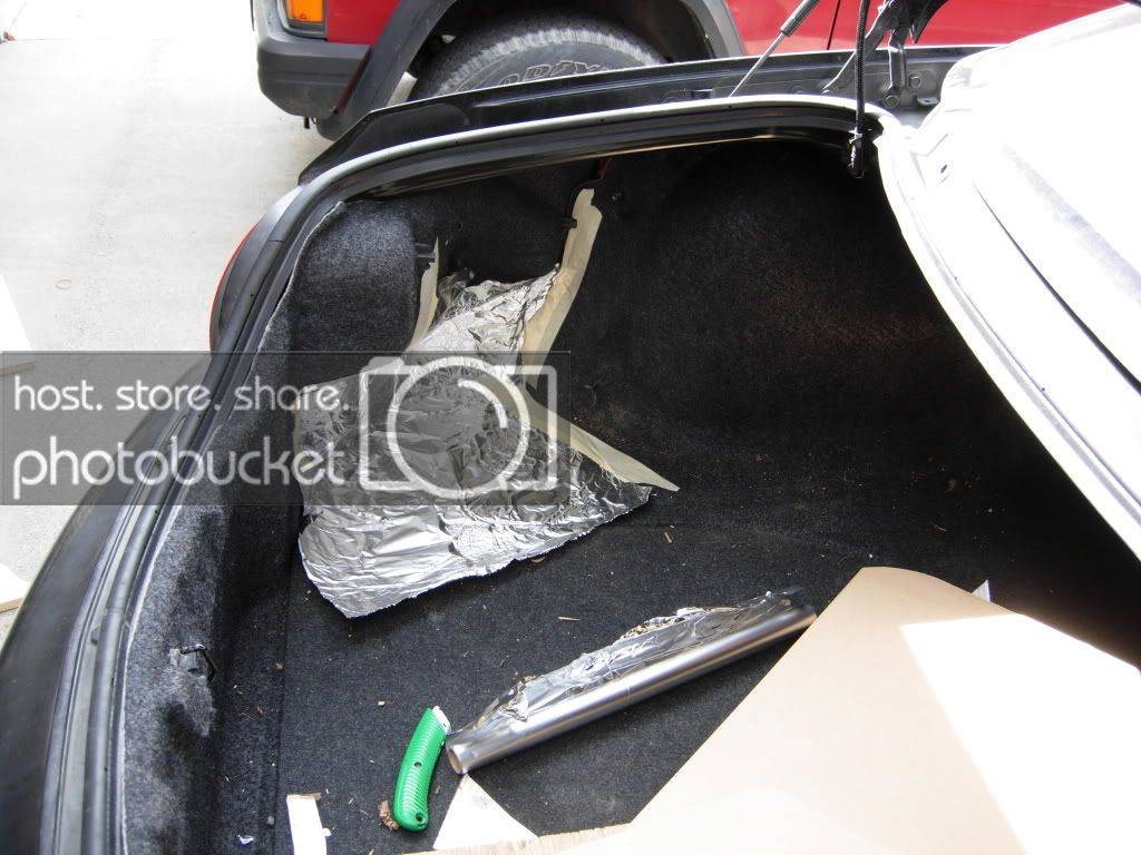

7. Make sure you seal up where your molding really well in your car with foil and tape, but don’t obsess about it, I didn’t do as good of a job as most people I’ve seen on the internet and still didn’t get any leaks.
8. Unless you have latex allergy make sure to get latex gloves, not vinyl. I accidently bought vinyl when I went back for more (10 pairs is not enough) and they ****.
9. Mixing: I used red party cups for mixing, strips of mdf for stirring, and used low rough estimates on the amount of hardener to use, and it worked out fine.
10: If you use the directions on the can (Bondo Brand), you’ll likely run out of hardener way fast, and run out of time while your working, be stingy with your hardener. I got away with only buying one extra tube with my gallon and a half of resin, and the fiberglass was still curing up pretty fast. It was ready to handle in about a half hour to an hour after doing a layer.

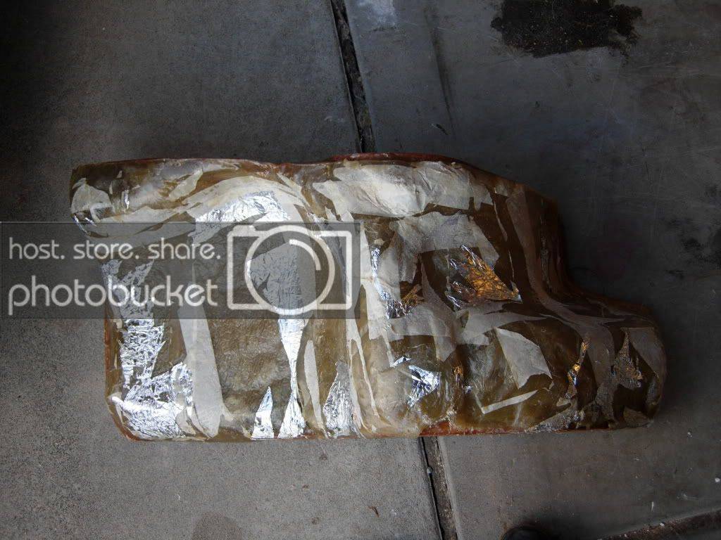

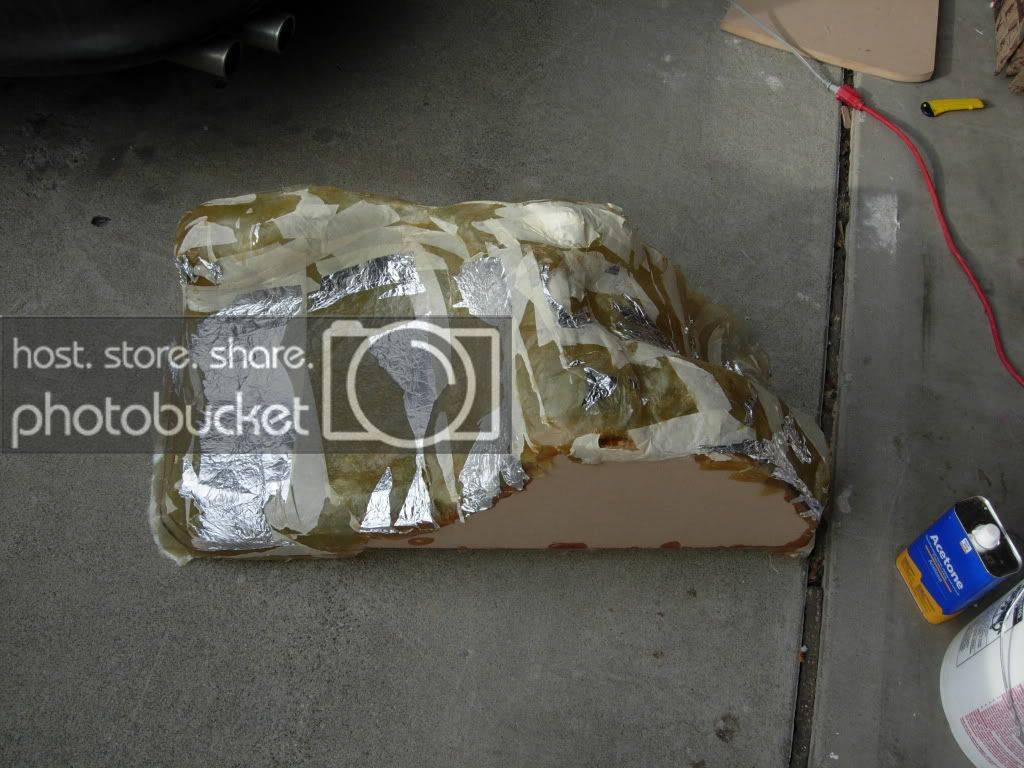

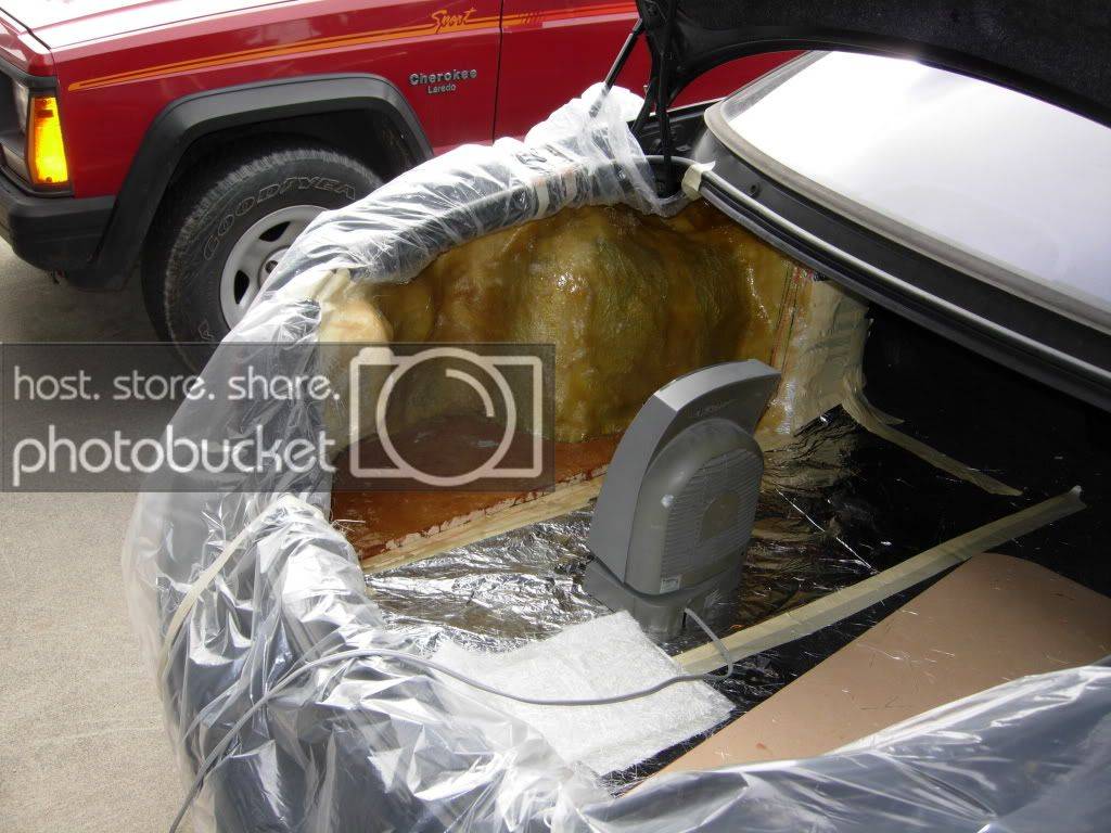

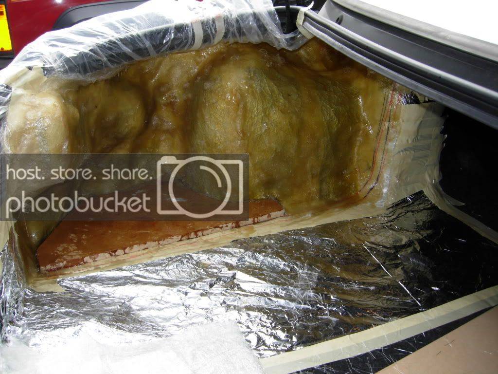

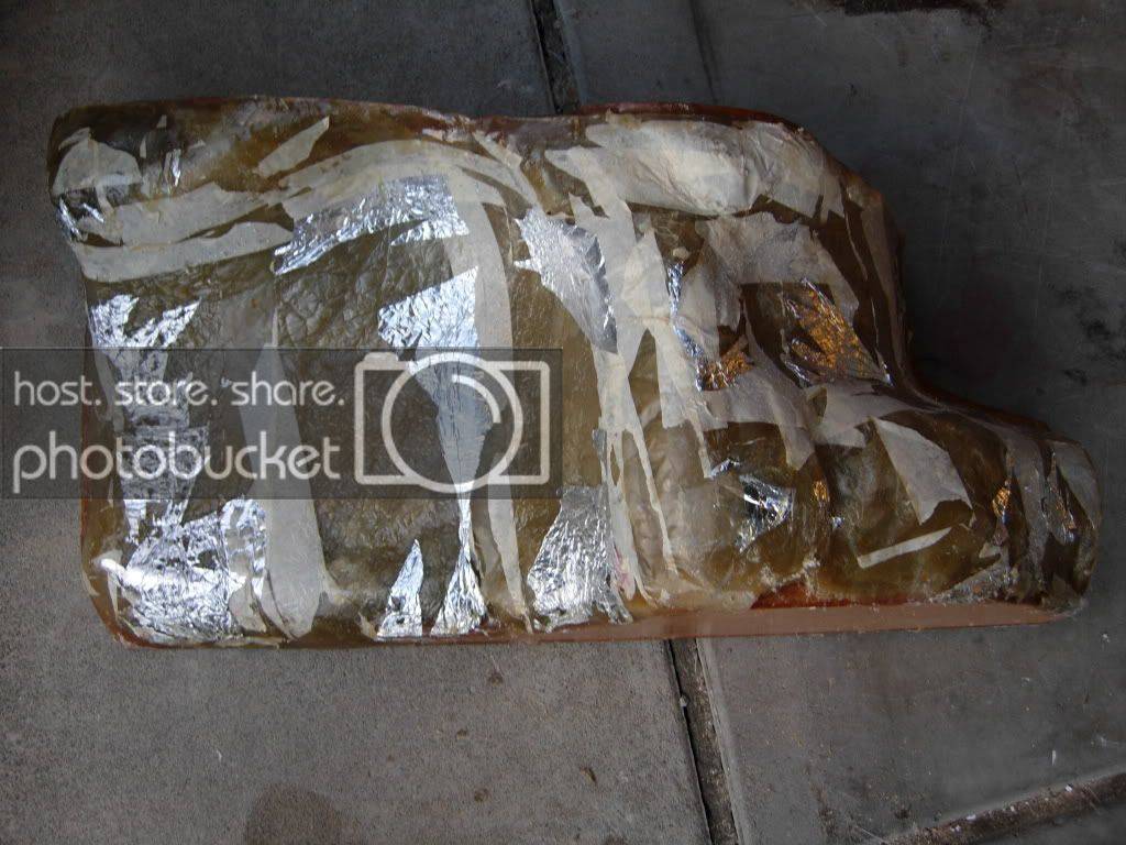

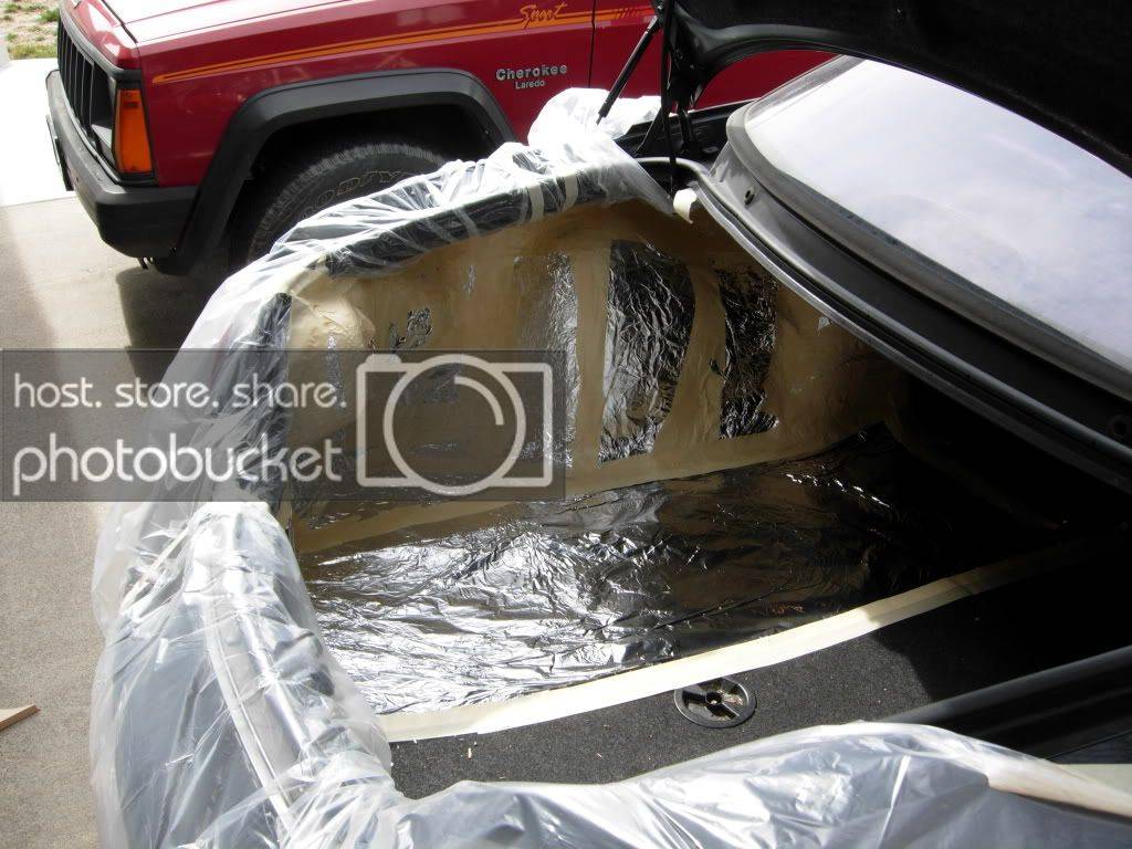

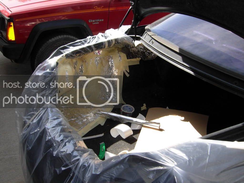

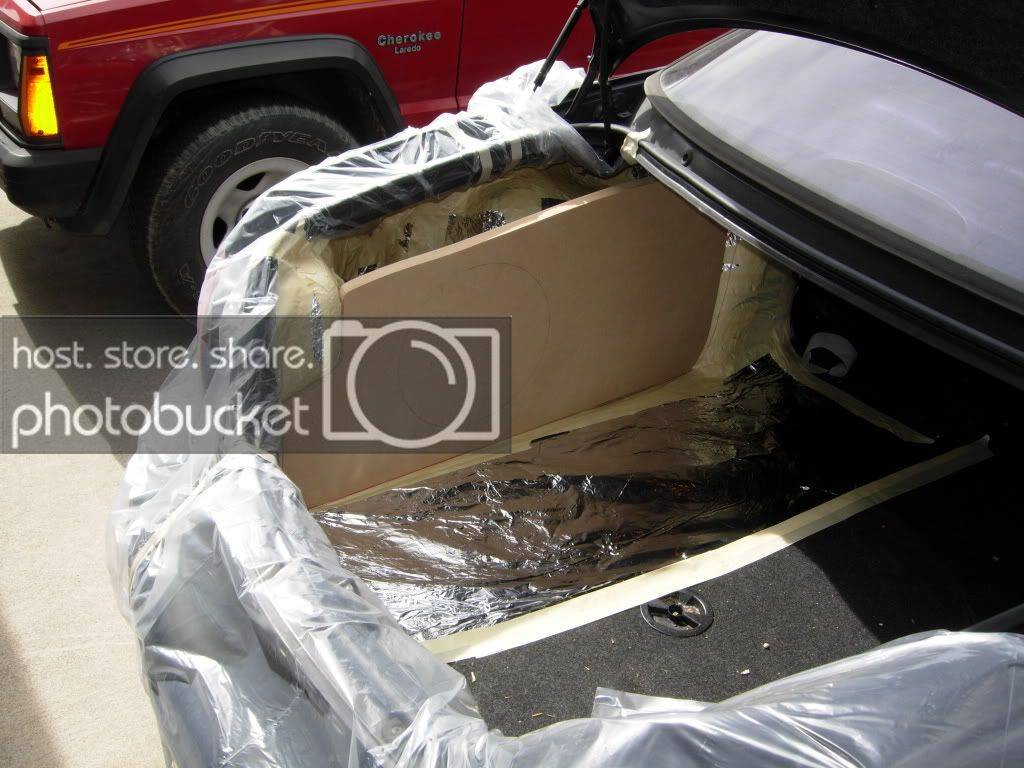

Here are the pics of the first day, the prep and layup went pretty well, I’d say about 2 hours for prep and about 4 hours for the three layers of glass, with plenty of beer/drying breaks in between.
If your wondering what that fan thingy is, its a portable heater, it really helped it cure up faster, especially since it was a chilly weekend (in the 50's)
Look ma! No leaks!

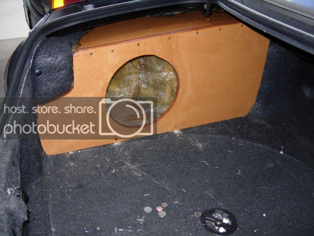

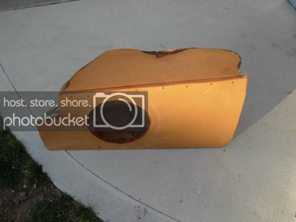

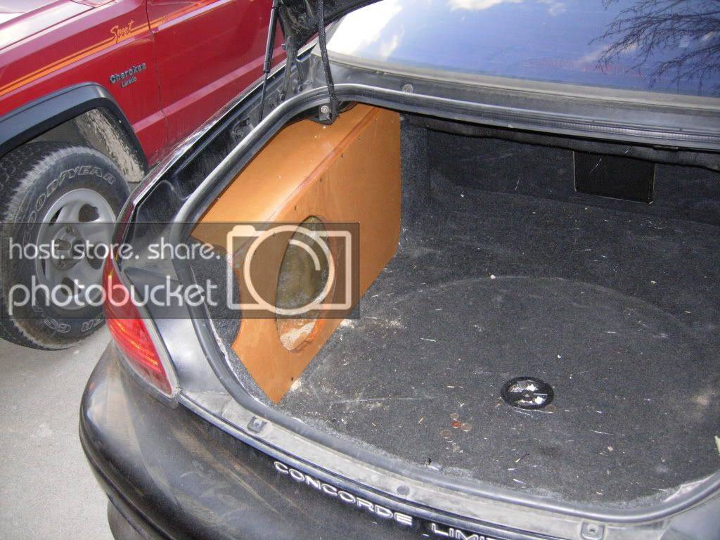

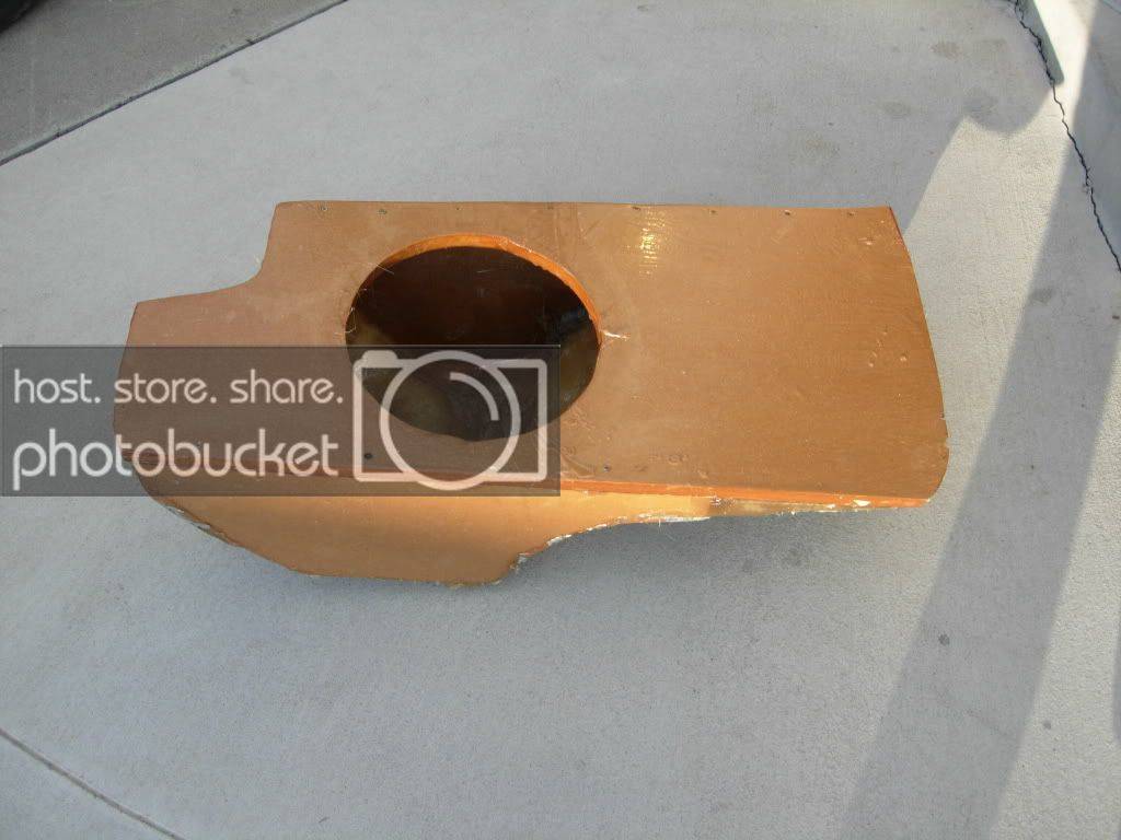

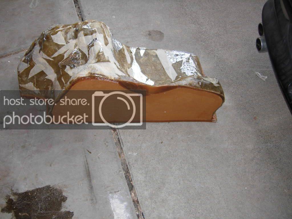

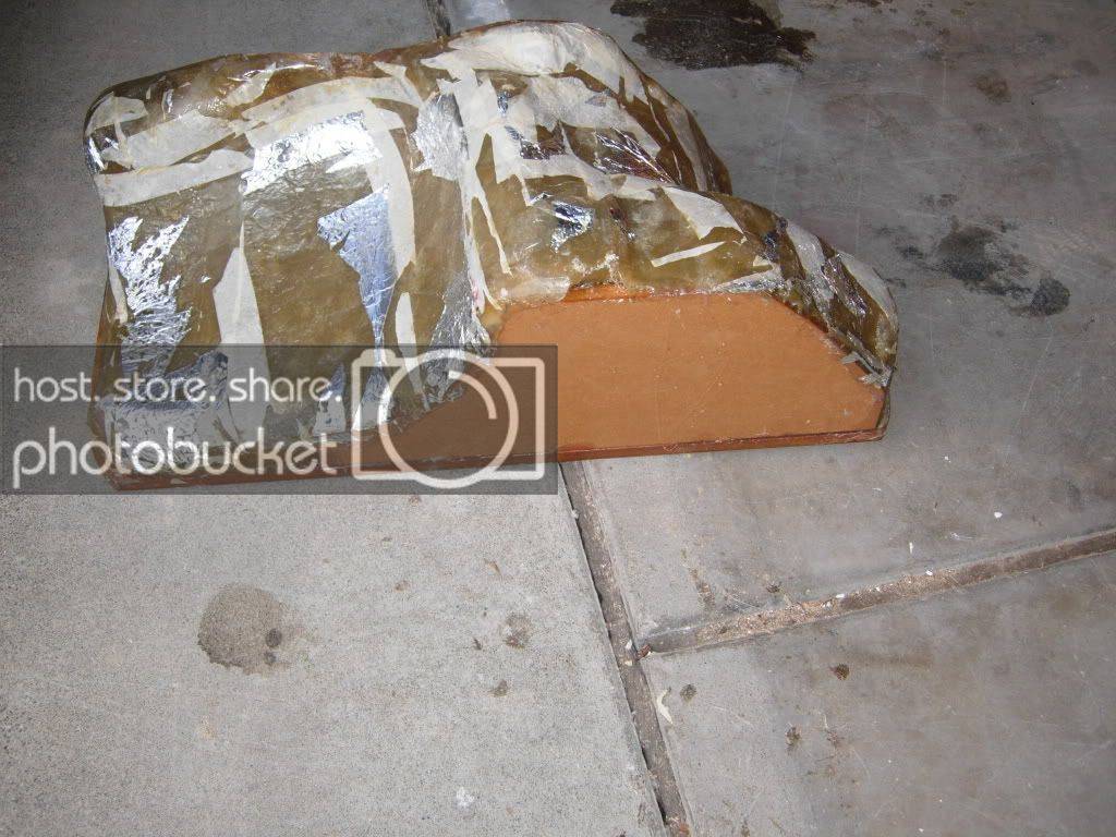

Here are the pics from the second day. I trimmed the mold with a jigsaw, and actually got it pretty close for a good fit. I put it all together in the car, then I screwed my front board to the board I used on the bottom of the mold, then I taped all around the edges to keep resin from leaking out, then went ahead and glassed the corners together from the inside.
Then I cut out the top piece to fit inside the mold, and screwed it in from the front. Now for the hard part... glassing in that top board by reaching through the sub mounting hole. I got tons of resin on my arms trying to do this, and I’m a bit worried about the structural integrity of the joint at that far small end, but I put tons of resin in it, and I know its at least sealed well, and glued together with resin, we’ll just hope it holds together I guess.
I get the sub today, and the amp tomorrow, so I can put it in and check for air leaks and what not.
It feels dang solid, I went over it all and pushed on it all, and there’s no flex at all, and its all fairly thick, so I guess it’s done until I find the carpet.
