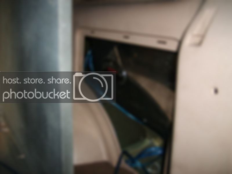

I ran some of this welding wire for my MTX 81000D
Where it exits to the engine compartment and how it weaves into factory holes, grommets are on now

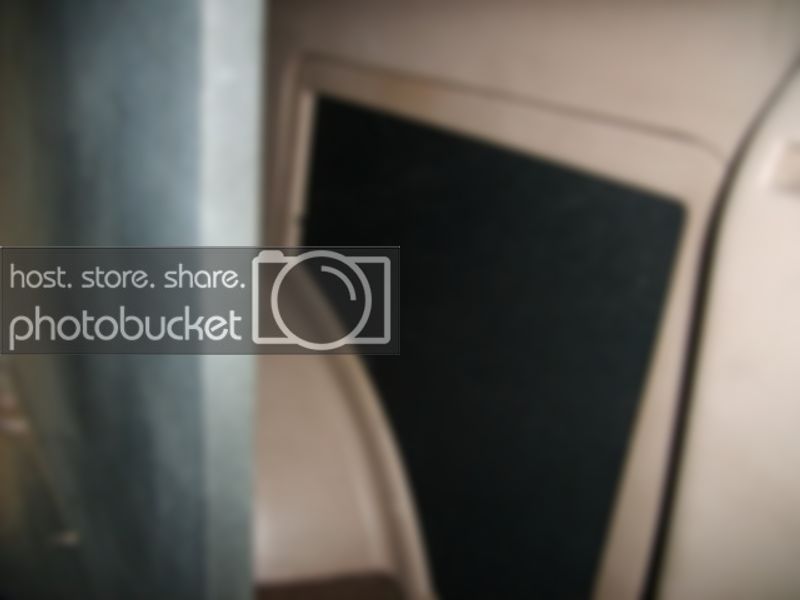

This is the MTX hidden where the factory cargo net used to be
This is the "custom" cover i made to make it look better

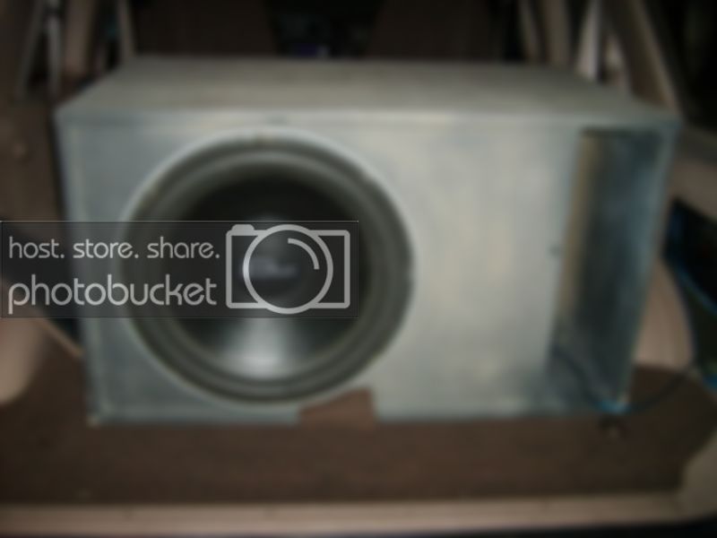

This is my huge and ugly box with my 18" Q, need to paint with matching flexstone

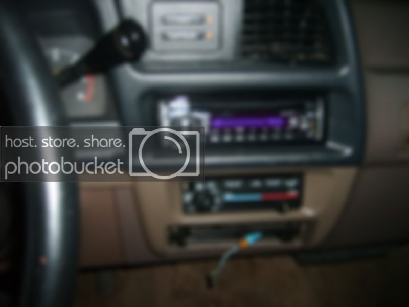

My kenwood kdc-x491, absolutely LOVE it, best HU to date

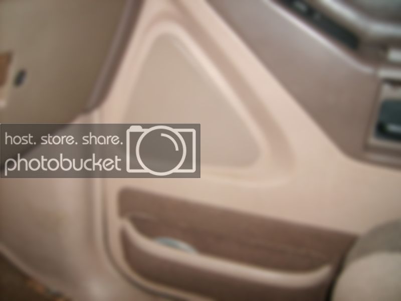

Upfront is infinity 6x9s. do the job great, comps will be later hopefully

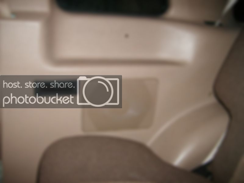

Rear kenwood fill, same as Audiobahnuser's, and in an explorer sport no less

hey man can you tell me more in depth how u ran the 1/0awg and how you hid your amp in that cargo area i have the same thing i really do like that idea.very nice work so far to man.
The 0 gauge goes into the fener, exits near the passenger door. If you look there is a factory hole in the body perfect for the wire. It runs into the interior, hidden behind the kick and fits snugly under the carpet in the wire tunnel and goes into the giant passenger rear side panel. It runs under the rear pass 5x7 and then the the amp.
The amp is mounted where my factory amp was. Simply removed the old amp. I mounted the amp with holes that were already in the body under the rear window. Everything is hidden and I love it. When i need to haul something i just grab my box and take it out, as opposed to having my amp screwed to the box like i used to. I took the frame of the stock cargo net and attached black polyester and voila. By far the hardest thing was being driven crazy the whole time by the rediculously big interior plastic, since i broke my t50 bit so i couldnt get the seatbelts out, but i dealt with it.
