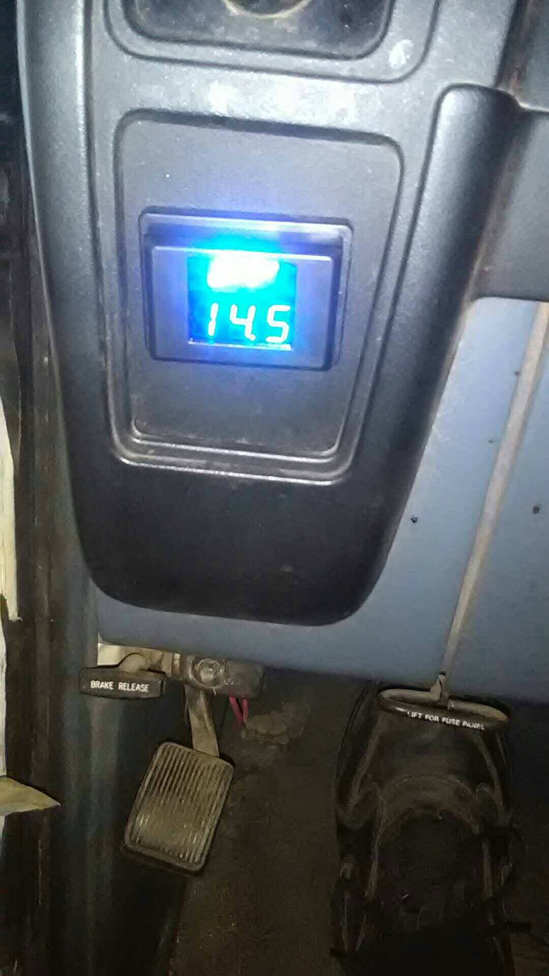

new stinger volt meter. Vehicle warmed up idles at 14.5-14.3v not bad need to get a sub again to see how much voltage drops

Heh.. When did you measure the voltage difference? I'm assuming at rest..
You need to measure voltage difference at maximum output so resistance in all connections is then accounted for.
Just like water leak.. Wherever the hole is is where it drops.. Water doesn't leak everywhere if there is only 1 hole.
I set it .1v lower than what the DMM read so I figured I'd be safe but I'll redo it
