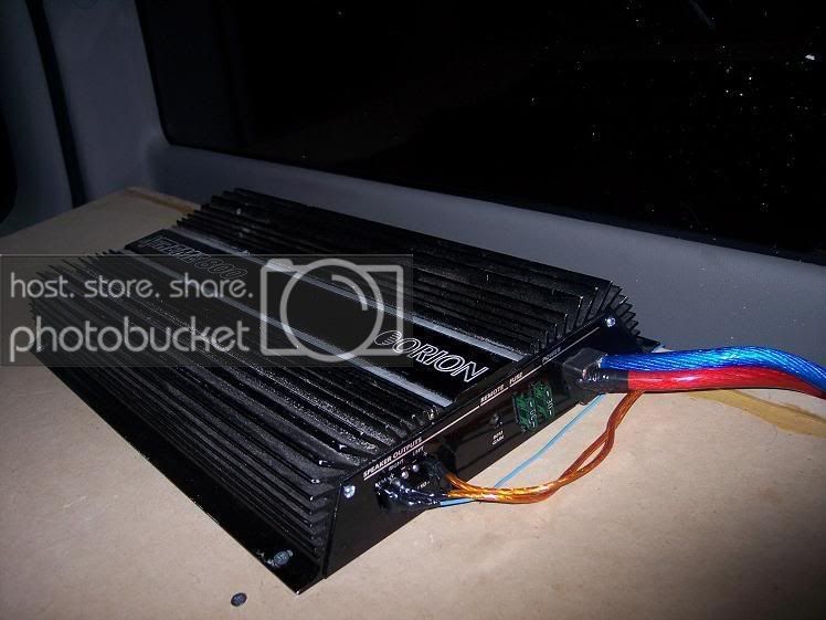

so i got this amp.
its 800 watts bridged at 4 ohms.
i got a nice deal on it so i took it.
