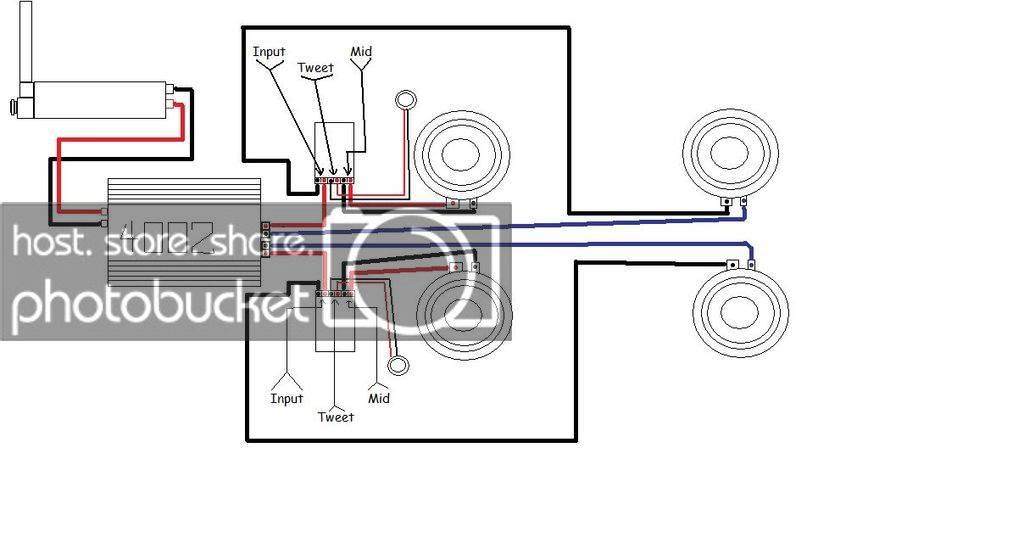

Im wanting to wire both my CTX65CS, and ID oem's to my Orion 4002 @ 2 ohm's.
I want to keep my left speakers wired to my left channel of my amp, And right speakers on Right channel of amp. So far this is what ive come up with. Can someone go over it, And make sure im correct?
So Ive been looking over this for the past 10 minutes, Your ID OEMs wont work, I dont believe because you are connecting them to nothing.
Negative from the amp to them (ID's) then positive terminal to the negative on the xover, so it doesnt connect back to the positive.
About the only way you could do it is to bridge it at the xover, but then your tweeter would be a different load.
