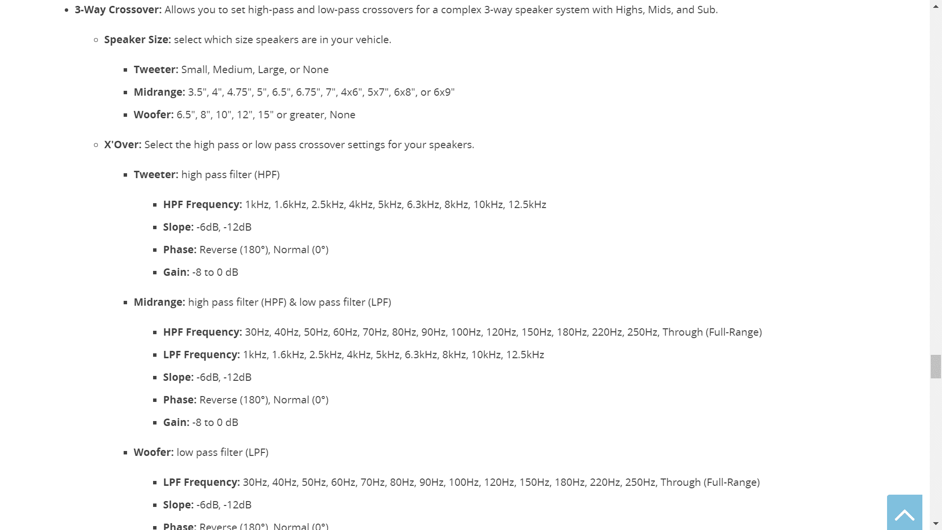

these are the JVC's crossover functions
Ok I didn't see all of this the first time lol, this helps a bunch more, I didn't see this detailed of an discription on the jvc either that makes a lot more sense now and what I am needing.
