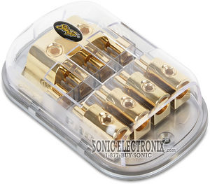

not three fuse holders, just one fused distribution block
i use this (not the gold version)
Stinger SPD8623 PRO Series Maxi Fused Power Distribution Block
has 1/0 in and out, then four 4awg outputs. no need to fuse the 1/0 to the sub amp since it is already fused at the battery. you just want to fuse the smaller 4awg run to the smaller amp.
