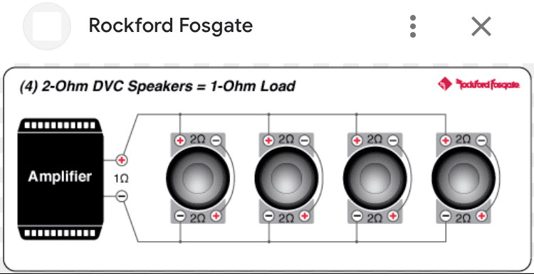

To your questions that you can't let go Rob I will give you this. Do I think it will help you, no, but here you go anyway.
Bridged is another word used to say "connected" My positive outputS are bridged (Connected) internally as well are the negative outputS.
"Bridged" means two branches are connected by a THIRD branch. When two wires touch, there is no THIRD branch. They are simply connected, not "bridged".
And in electronics, "bridged" refers "a method of connecting a load to two amplifiers to increase available voltage, called a bridged amplifier."
NO ONE in car audio should ever think they have "bridged" their system by running speakers in parallel off a mono amp.
