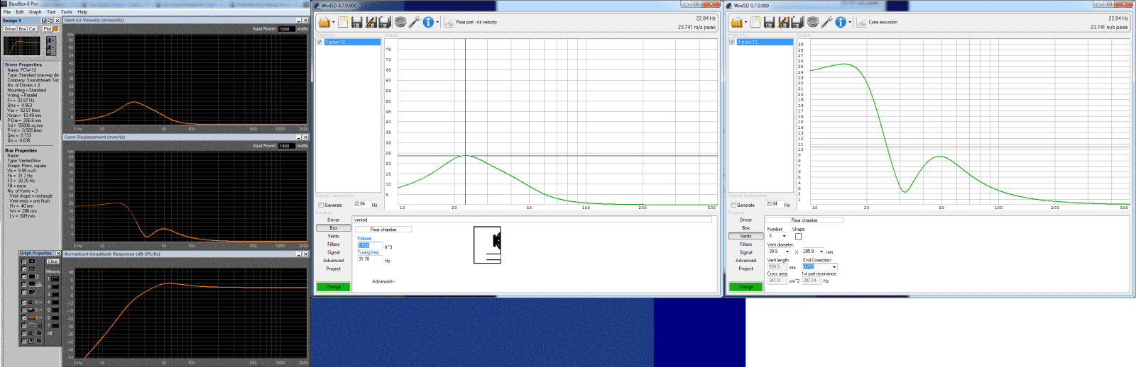

Why do these softwares give different values for these. In bassboxpro I have box fill set to none and I modelled my box in both programs with the same ports/volumes/power but both gave different results.
http://i43.tinypic.com/2zejdi8.png
Online port length calculators agree more with winisd, and on a previous box I designed (tuned to 25.5hz) I actually found the tuning frequency by using test tones and checking excursion. The box was designed with winISD and the tuning frequency was correct. I find it hard to believe that the freeware and online calculators get more accurate results than a paid software.
Anyone know why these softwares give different port lengths and port velocities?

I'm just skeptical because winisd worked for me in the past and is backed up by many other port length calculators.
I only just started using BBP6 recently.
The only real concern is the higher wind speed read in winisd compared to BBP. that means if I was getting 23m/s port velocity in winISD I'd actually be getting 18m/s according to BBP6. And my ports are REALLY small (I have 3 they're 1.57"x11.25" each), it's pretty much the reason why I'm building a new box.
