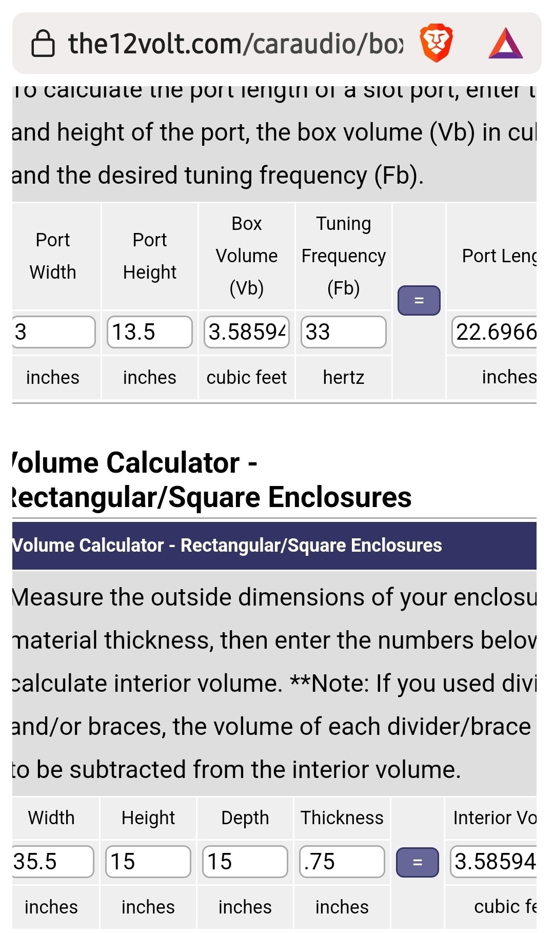

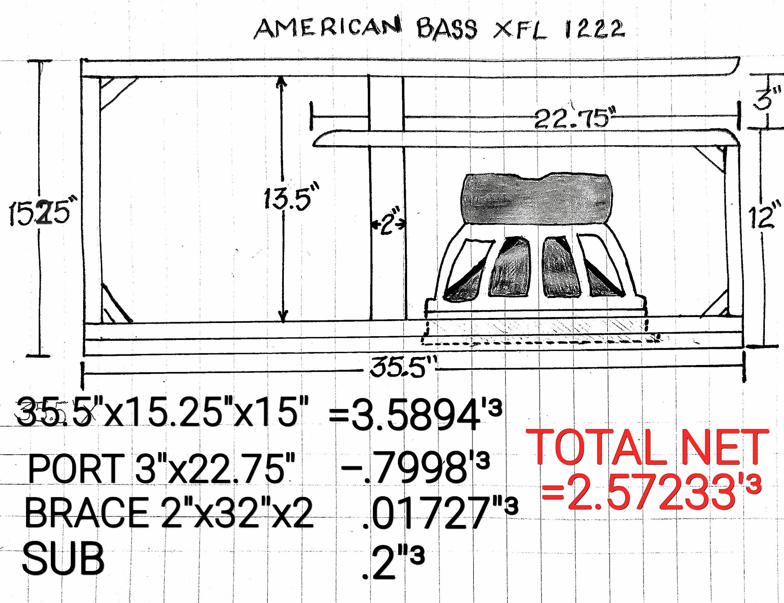

Couldn't get no help with my 1st post so trying to figure it out on my own. AB XFL 1222 on a RF 1200w RMS in a Chevy Silverado Ext Cab. Any input on this design? Good, bad? Anything I should change. Many, many thanks to anyone offering input!
EDIT for mistake.:
Should be OD 35"x15"x15.75"
2"'x13.50'' Dowel brace.

Looks good to me. . Those subs love power. In future, I would recommend you up power to at least 2k. Otherwise, I say go with it. Nice drawing!!👍🏽
Should sound pretty good in rear Seat .. Sub up Port up.. or remove back seat and insulate the backwall below window line and do Sub up Port up. Great subs. They get down for the money, Seem to Last, and it will take that RF amp all day long. A nice set of components or a nice 3 way set on about 100-150 RMS will blend very nicely
I always think a double baffle is wasted if the sub is only on the first baffle.

I've wondered about that. I just figured it would make it stronger and see a lot of others doing it. I do have a brother who does wood work and will be helping me with straight cuts but I have no idea what I'm doing as far as.design.
I have 36''x15''x15'' to work with and trying to get 2.5' net and the more I go over my figures, the more it gets out of whack.

I was wanting to face the sub down at the floor. Would have about 4" clearance. Do you think that's a bad idea?

4” clearance is a good idea imo. I’ve seen some downfiring setups that had as little as 1” clearance and I wonder how it sounds. Seems the surround would rub the floor. My downfiring setup will be around 3” clearance.

Down firing into the carpet..You loose quite a bit of Acoustics and a low output on sub stage. For Some.. Its all they need though. Doesnt hurt to try it out. Id leave enough speaker wiring so you can move the sub around like up in the back seat to try thet method Sub Up Port up also. Alpine still makes Great stuff.
