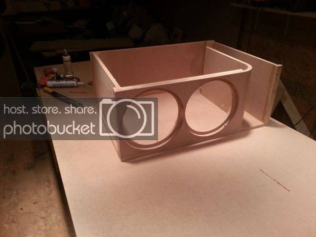

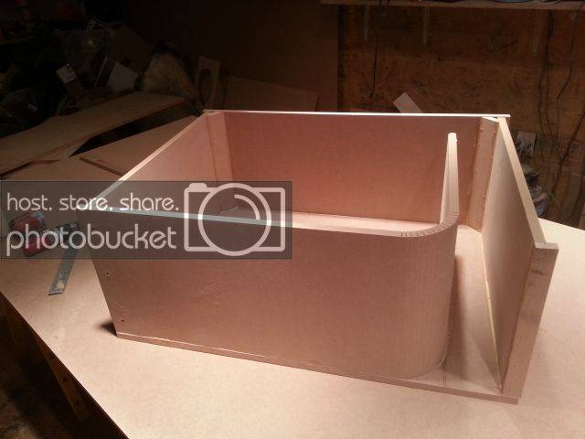

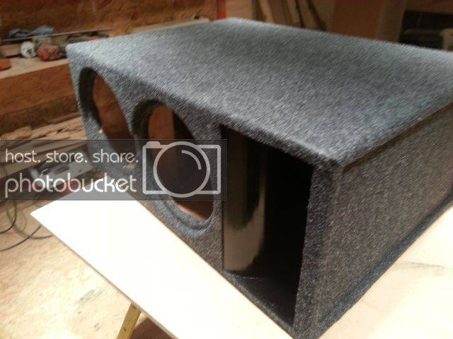

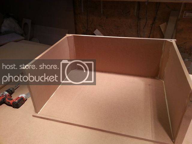

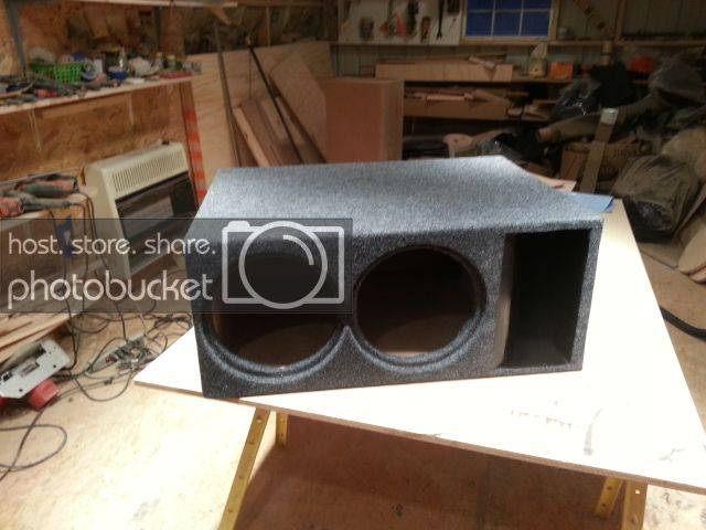

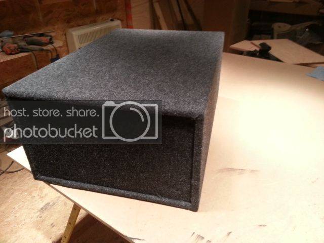

Pair of LI 12s......4.2cf net @ 32hz........flush mount....kerf port.....charcoal wrap with black port...
