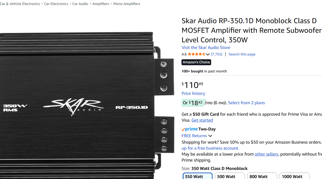

Are you planning to use the amp for the sub only, or to power your mains, too? If sub-only, you're better with a mono amp.
Not a product recommendation (opinions on Skar are all over the map), but for $110, you could get 350watts: https://www.amazon.com/dp/B01LW8V8CD/?tag=caraudiocom-20

If running the sub @ 2 ohms I'd not get the Skar mentioned above it would not offer anything over the alpine and would be a waste of money.
