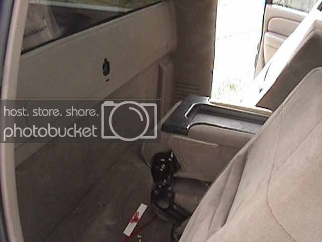

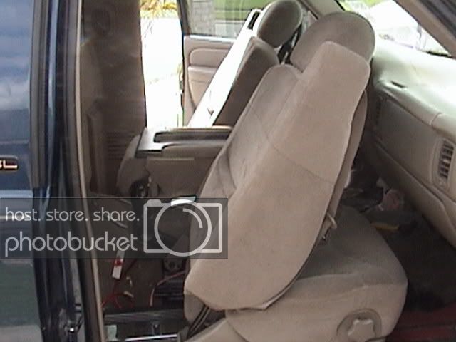

Allready had sum1 to wire up my truck, all i need is the boxes lol. aND bTW THE CONSOLE DOES NOT MOVE! REALLY GAY PART OF MY TRUCK!
That is one of the gayest things about those trucks. My friends has an 02 reg cab and he doesnt even have the console. Just a bench seat with something that you would think would fold down.Which it doesnt. But he has two of my old truck boxes behind his seat. His shit sounds good.

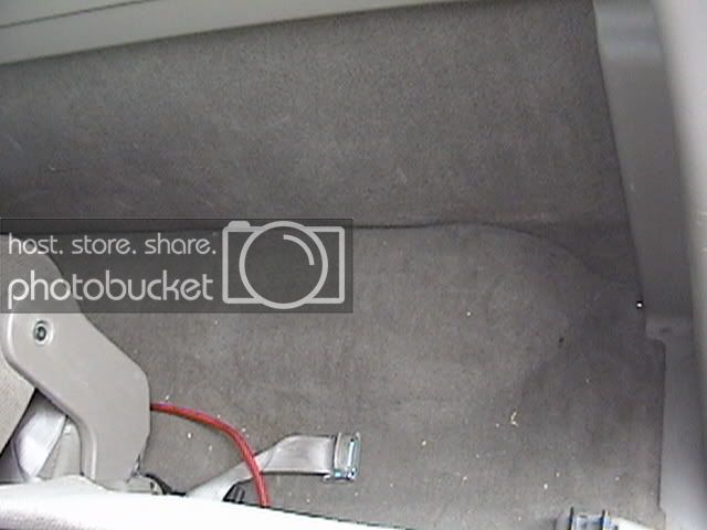

how about 2 sealed boxes, one behind each seat? or maybe u could fit a ported... do some measuring and let us know the max dimensions for a box you'd be willing to put in
Yeah, the nonsliding console is a pain for fitting subs.

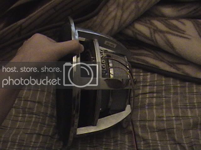

For sealed enclosures, Audiobahn shows a range of .5 cf min to 1.5 cf max. 1 cf per sub might be a good number depending on what kind of power your giving them. Ported, they recommend 1.8 cf not including the port or sub displacement. If the mounting depth on the subs is shallow, you should be able to get them back there sealed but you might lose a bit of legroom in the process.

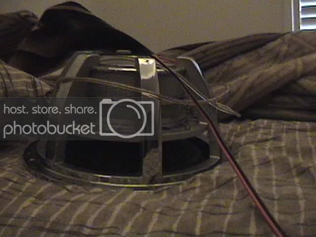

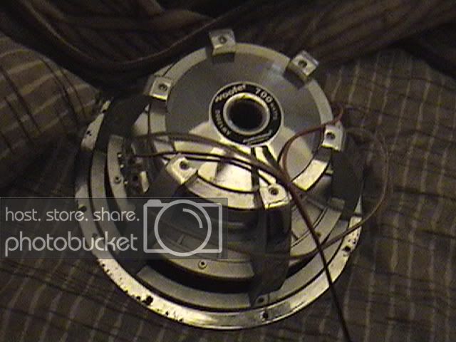

lol thought sum1 would find it funny, umm there audiobahns 12inchs @ 1 ohm, 700 watts a peice, they were upgraded 2 @ 1 ohm btw. Budget... well jus give ideas. sealed will actually do best unless any1 has anything to say about it.
