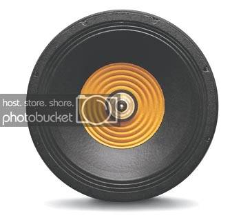

After looking around more, I found something that fits exactly what I'm talking about: http://www.parts-express.com/pe/showdetl.cfm?Partnumber=294-676
4" VC with 1kw power handling
low qts
fs of 34hz
97db efficiency
decent xmax of 10mm
