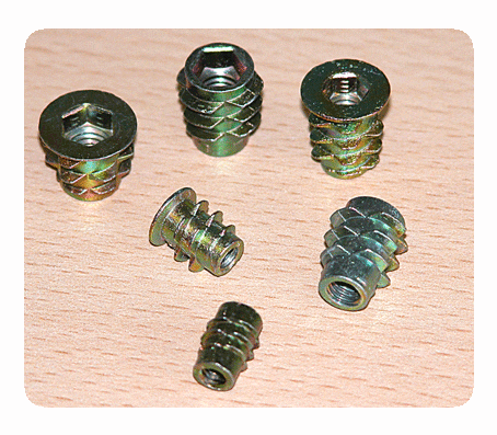

You might try using bolts and hurricane nuts (should be available at local hardware store). The nuts will keep you from stripping the wood and will give you a more secure mount for the bolts because it's metal on metal. They look like this:
Best option in most cases. Not all, but most.
Will they fit in the existing screw holes in the box?
No, you will probably have to drill the hole out larger. Keep in mind when installing these your holes need to be fairly accurate. Metal threads aren't nearly as forgiving as MDF so if your hole is off slightly or the nut is threaded in crooked it will be a PITA to get the bolt in...
Hurricane nuts are a lot like T-nuts....except stronger //content.invisioncic.com/y282845/emoticons/fyi.gif.9f1f679348da7204ce960cfc74bca8e0.gif
