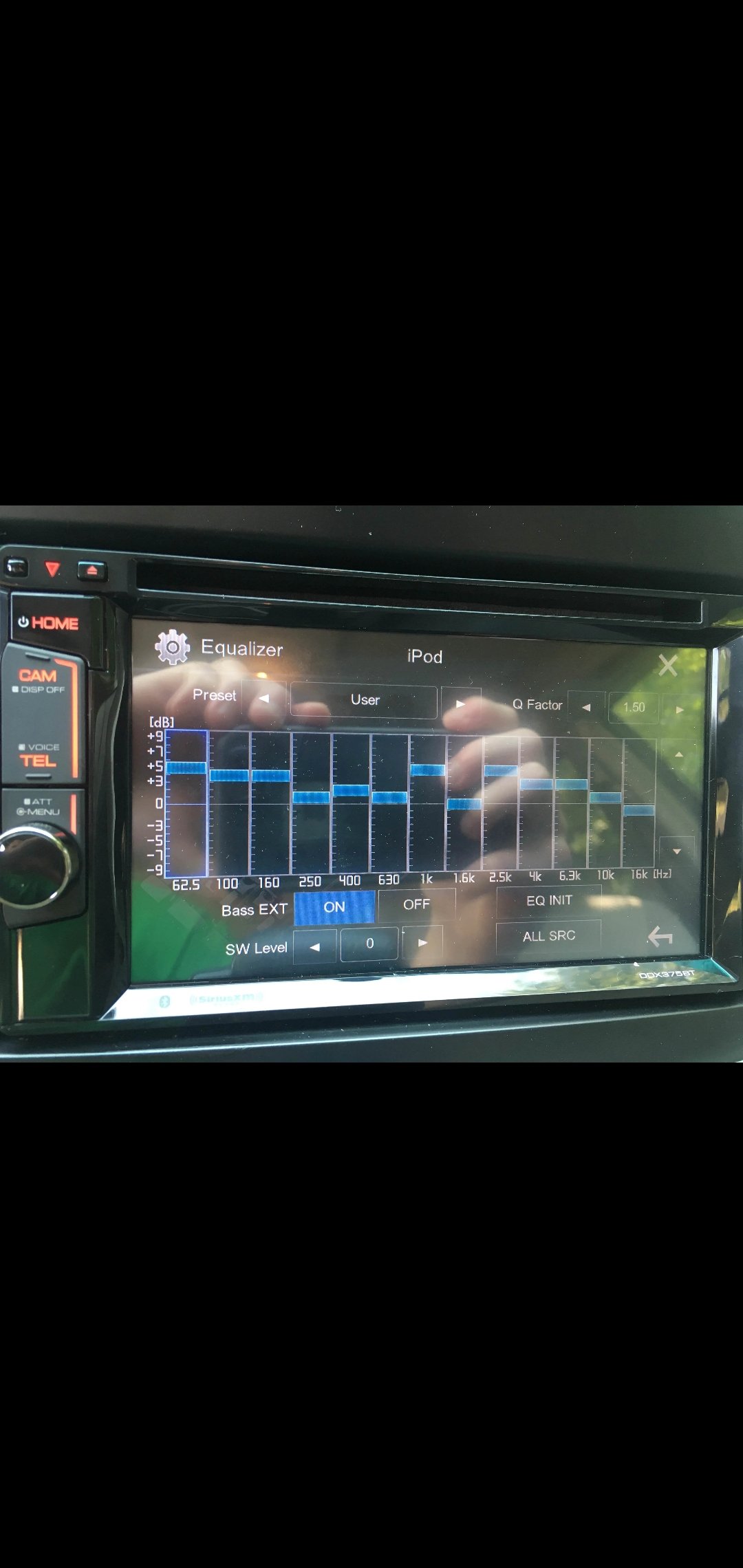

Few things. Headunit just has an equalizer. No other controls. I'm assuming the first 3 are bass so max them to the top? Also do adjust anything else on the equalizer? I'm assuming crossover is LPF on the dials? What do I set frequency at? Also, the amp doesn't have a yellow light assuming that's clipping nor does the bass knob, just two blue lights for power. I'll include pictures of all if you go over then for the equalizer and each dial setting and I guess I'll have to listen for clipping.
Also, what should I use to tune it with if you can include some type of recommended audio. After it's tuned, do I always keep the head unit at 80-85% power? Will turning it up to say 33/35 cause the subs to possibly blow again? Sorry for so many questions and thank you for all the help.
View attachment 39858View attachment 39859View attachment 39860View attachment 39861
This is where I would start. Turn your HU up to max volume before distortion kicks in and set the bass knob at 50%. I would leave the first two on your EQ at 0. Find a bass heavy song and then slowly turn the gain up until the protect light slightly flickers and then back it off an ⅛" or so until it doesn't flicker anymore. You should be golden after that. Don't go "full tilt" for a couple of weeks to allow the suspension to loosen up. It's hard to do.
