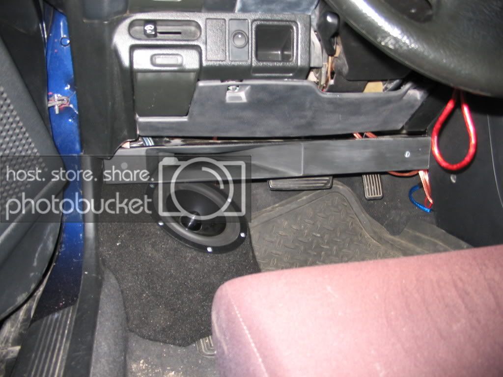

On a related note, this is me demonstrating how not to install horn throats...
I noticed eventually //content.invisioncic.com/y282845/emoticons/biggrin.gif.d71a5d36fcbab170f2364c9f2e3946cb.gif
