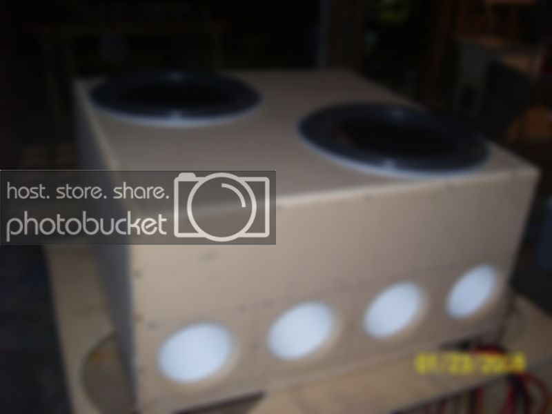

derrick i see u watching i got 1 question Where did u get ur roundover bit and what size is it? i would like to do my 6" pipe the same way u did
Its 5/8" and I believe my bro got it at Sears. I just recently picked up a 3/4" from Lowes but haven't used it yet. The ports were easy to make, cheap, and work excellent.
I guess I'm not allowed into the 2 18s club since I have 3 now. //content.invisioncic.com/y282845/emoticons/crying.gif.ec0ebefe590df0251476573bc49e46d8.gif When I had 2 in 10 ft w/ 4 6" ports tuned to 32hz it hit a 148.3 @ 41hz powered by a pair of Sundown 1500s in my Yukon.

I tried strapping my Sundowns once which took them down to 0.1875ohm each and it hit a 149.5 but the amps kept going into protect as soon as I got up to half volume. In my Explorer this box hit a 147.2 off of one Sundown 1500 @ 0.5ohm. Here's a pic of the box.
