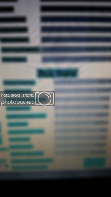

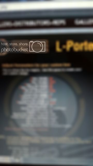

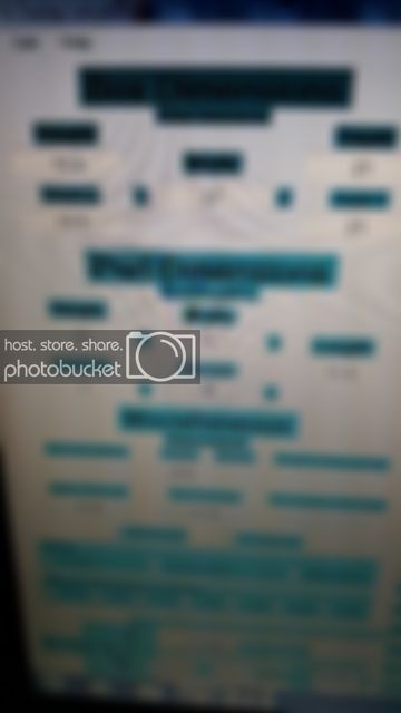

I made my subwoofer box using RE calc but been told it sux so i downloaded the torres box calc. Now im trying to figure out how much cubes my box is and what its tuned to. I am also trying to figure out how much space i have to work with.
Here are pics of re cal and then torres. but remember i built box using re calc
the displacement .416 is for the 2 12 xfl subs i had.

It says it at the bottom of the third pic. Net volume is 4.25 cubes tuned to 28hz. I would trust what torres says.

even if i built it going by re calc? This is an old box and i want to rebuild new but if its really tuned to 28 hz thats really low. I thought it was 33.-
How many pieces of wood did you use for the port? When you entered it into torres, you only used the length of the rear port, so your port length is only 11.5", when it's really 35" in total.
you didnt enter in the number of common port walls and why do you have aeroport and slot port numbers entered in? Choose one or the other.
