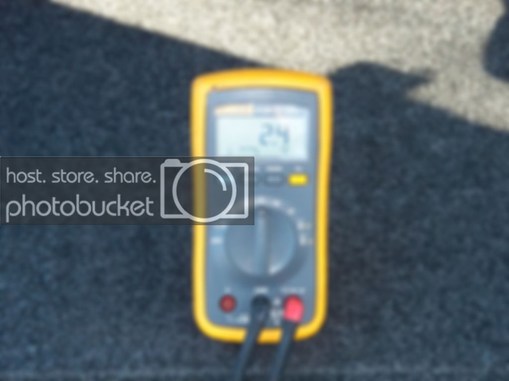

For a DMM I recommend Fluke as my choice I just love mine. To PROPERLY set your gains your going to need an oscilloscope for that which I do not have nor do I feel like investing in one.

HAHA you may laugh but just ask santa to bring you one this year that is how I got mine.//content.invisioncic.com/y282845/emoticons/tongue.gif.6130eb82179565f6db8d26d6001dcd24.gif//content.invisioncic.com/y282845/emoticons/laugh.gif.48439b2acf2cfca21620f01e7f77d1e4.gif Had it for 2 years and have never worked on a car without it or left home for that matter to work on one.
