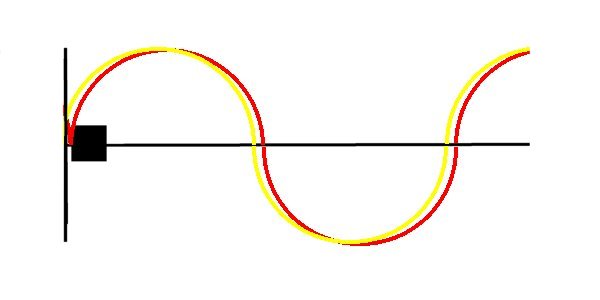

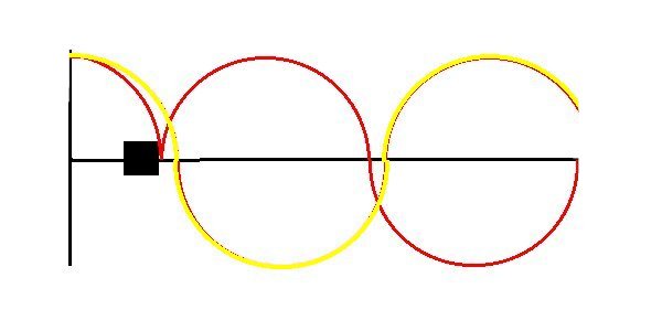

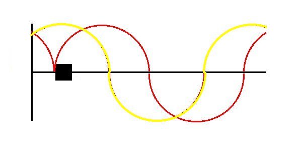

In this picture the vertical line is the back of the trunk and the black box is the subwoofer box which is facing towards the cabin. When the sub hits, the sound goes foward into the cabin (red wave) but also reflects off the back of the trunk to become the reflected wave. When those two waves are way out of alignment as shown in the picture there will be major cancellation. Simply opening the trunk will cause that reflected wave to "disappear" and not reflect back in the trunk and not cause cancellation in the process.
In this picture the sub is aimed at the trunk and the result is that the waves aren't nearly as out of phase as the first picture, resulting in much better bass response but still not as good as it can be.
In this picture the sub box is moved so it's closer to the back of the trunk with the sub firing towards the trunk resulting in the waves nearly being in phase with each other resulting in the best bass response.
