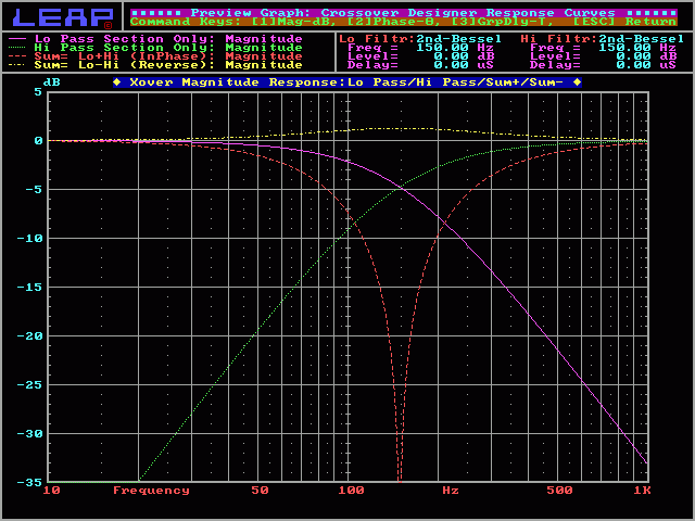

and the area shown dipping down is actually going to be add the two speakers, and fill in the dip:
purple = subwoofer response
green = front stage response
yellow = total response
here is what would happen if you set both crossovers to the same point:
you get a peak in response!
depending on the crossover slopes will determine how far apart the -3dB points of the crossovers should be set.

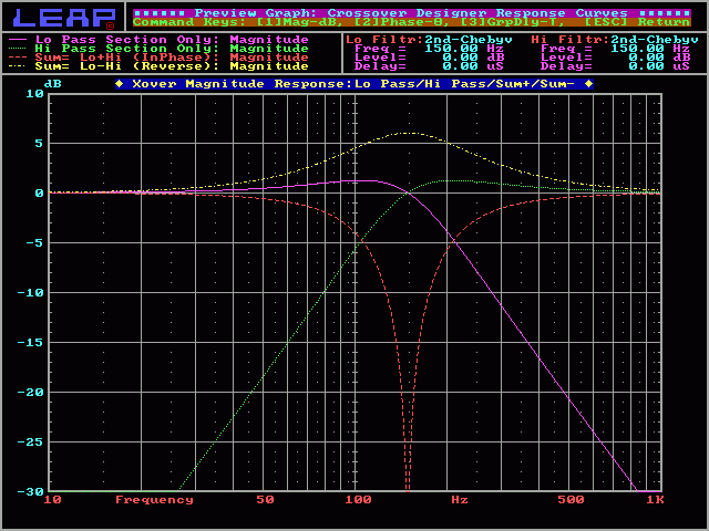

[img ]http://www.bcae1.com/images/gifs/xo2ndbea.gif[/img]
[img ]http://www.bcae1.com/images/gifs/xo2ndcha.gif[/img]
Well, that peak is assuming that there is no cancelation and that the subs and speakers are in phase.
