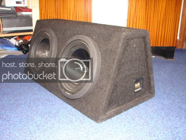

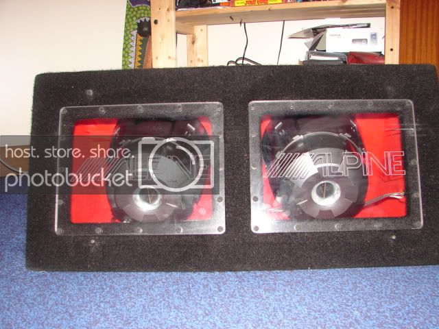

I think it sounds shit I have posted a picture of the sub box could this be the cause of the problem.
Can some one tell me where i could be going wrong ??
My Car - No much boot space
Box Front
Box Rear
2 subs in one chamber, one getting more power than the other.
Sounds like a problem to me.

1) Its a dual box “Sorry I should of said that from the start”

Could be that the amps aren't getting the juice they need. Each amp makes 1000w, so 2000w on a completely stock electrical is not good news. Do you know how many cubic feet per chamber that box is? Could be the box, too. You need to at least do the big 3, and maybe add a second battery.
