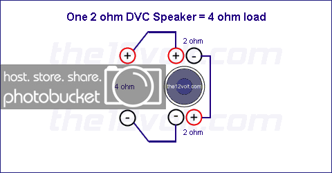

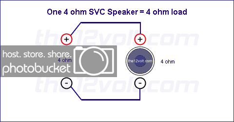

Ok. In the following two examples, the final load is the same. So, in a sealed enclosure, same model sub, what's going to be the difference?
Specifically, I have a JL Audio Stealthbox. I'll be putting in the intended 10w3v3. Just trying to decide whether I want to buy a 4ohm SVC sub, a 2ohm DVC sub, or even a 6ohm DVC sub to get a final load of 3ohms since that's what their site says it's loaded with if you buy one already done.
The single four ohm can only be wired to 4 ohms and the dual 2 ohm allows you to wire it down to one ohm if you decide to get a new amplifier in the future. Other than that they should be the same performance wise.

I'm just wondering if there's any sound difference particularly between a 4ohm SVC and 2 ohm DVC setup.
Thanks for the info mokedaddy. That's basically what I was guessing but wanted to make sure.
