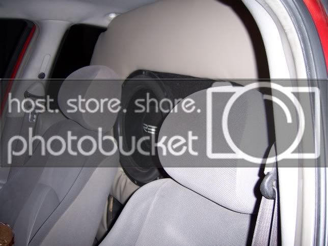

just because the finished pics arent up, doesnt mean it isnt finished.........
Its pretty clean lookin...
