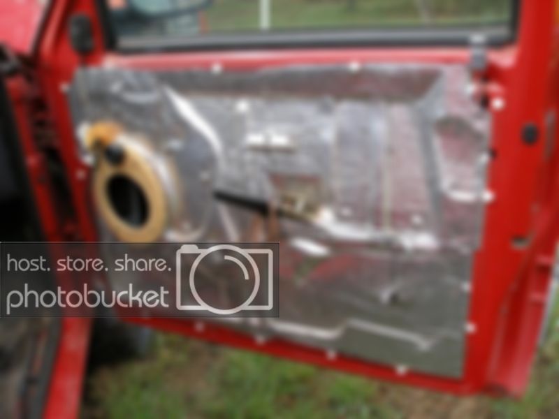

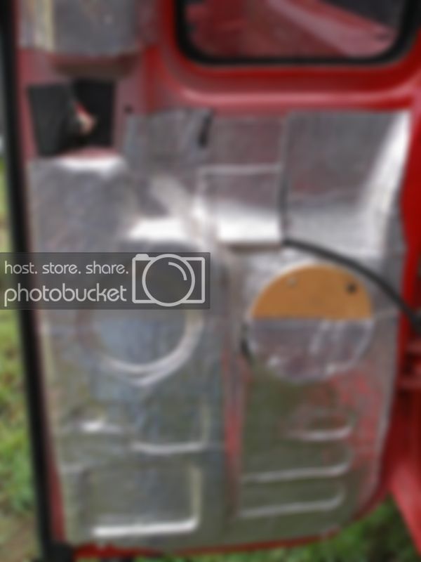

Here's the doors from my Dodge. One rear door still had some wood exposed to show you guys, so I chose it (even though its wrecked).

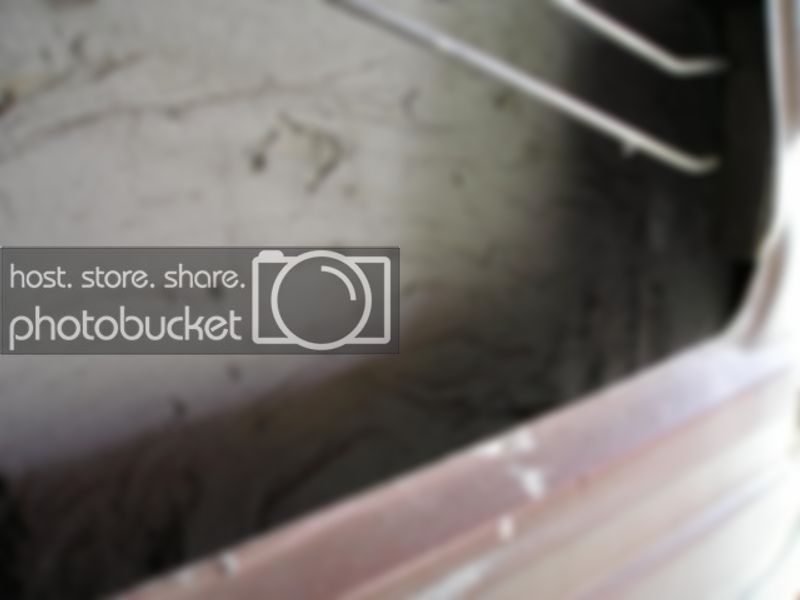

And here's the system I never got to hear:

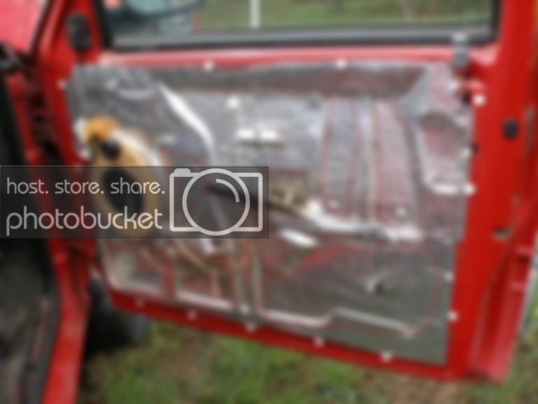

Lastly, I snapped a quick pic of a little of the concrete job in my Blazer doors. People have asked before, so here it is.
