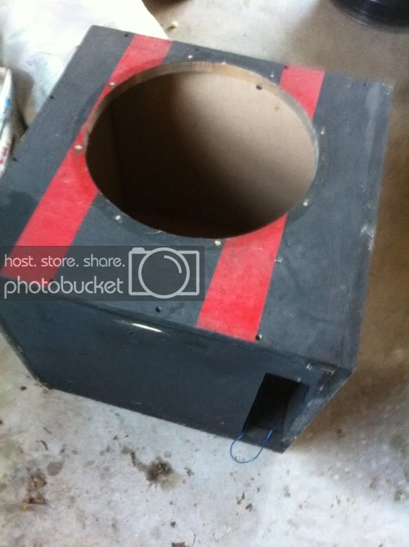

So a buddy of mine found this box, its made for a 15 but mine wont fit in it unless I invert it...Think its possible to make the circle a little larger? If it is, how would I go about doing it?
How much bigger?... could use sand paper or a wood file.
if you need like another 1/8 to 1/4 of an inch all around I would use a jig saw or router to just make a new cut, if you're good with tools and can cut a steady line.
you probably wouldn't want to invert it with the small hole as the surround would be likely to rub on the wood.
I was thinking of this too but you could potentially use a round over bit on the edge to at least curve it down a bit. You would just have to make sure your sub is sealed tight
true.. thats a good call with at least a round over router bit or something. I would just be worried cause it doesn't fit one way, it probably shouldn't fit inverted... without modification.

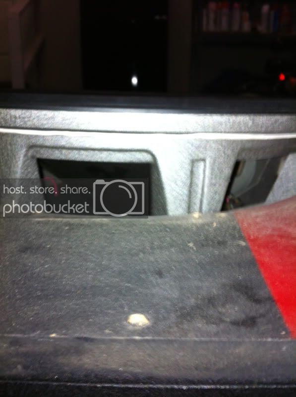

Thanks for all the feedback guys. Yeah I inverted it and tried it out...sounds like its leaking air and it sounds kinda funky too...oh man Im going to measure it and see the CF and tuning..

haha yeah the dimensions sound good but this is a huge problem //content.invisioncic.com/y282845/emoticons/frown.gif.a3531fa0534503350665a1e957861287.gif
haha, hot damn that is a little ways off isn't it.
you'd probably be way better off just building a new box man, especially if this one leaks from the seams haha.
But if you're just gonna use it till you get a chance to build a new one like you said, it should "work"
haha i have her inverted now....and i lined the basket or whatever its called with rope caulk...it has helped tremendously.
