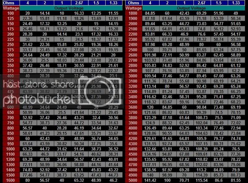

So if I understand correctly, setting your amp with -6 test tone will be louder than 0db test tone. Will this cause damage to the equipment? I am trying to get as much out of my system as possible without damaging anything.
No. -6 means negative 6. What does negative do? it reduces. And dont use a DMM to set your gains...that does not work.

I have done this for years how does this not work?
