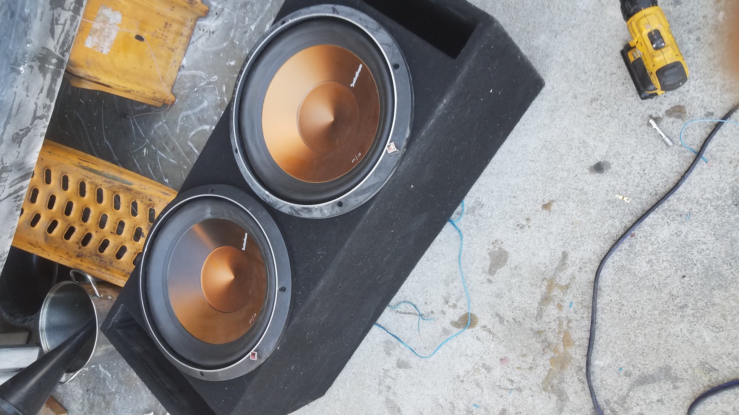

I have a pair of Rockford fosgate p3 12s and i cant seem to find them online anywhere. There like a bronze or gold. From what i can tell they were not paint.

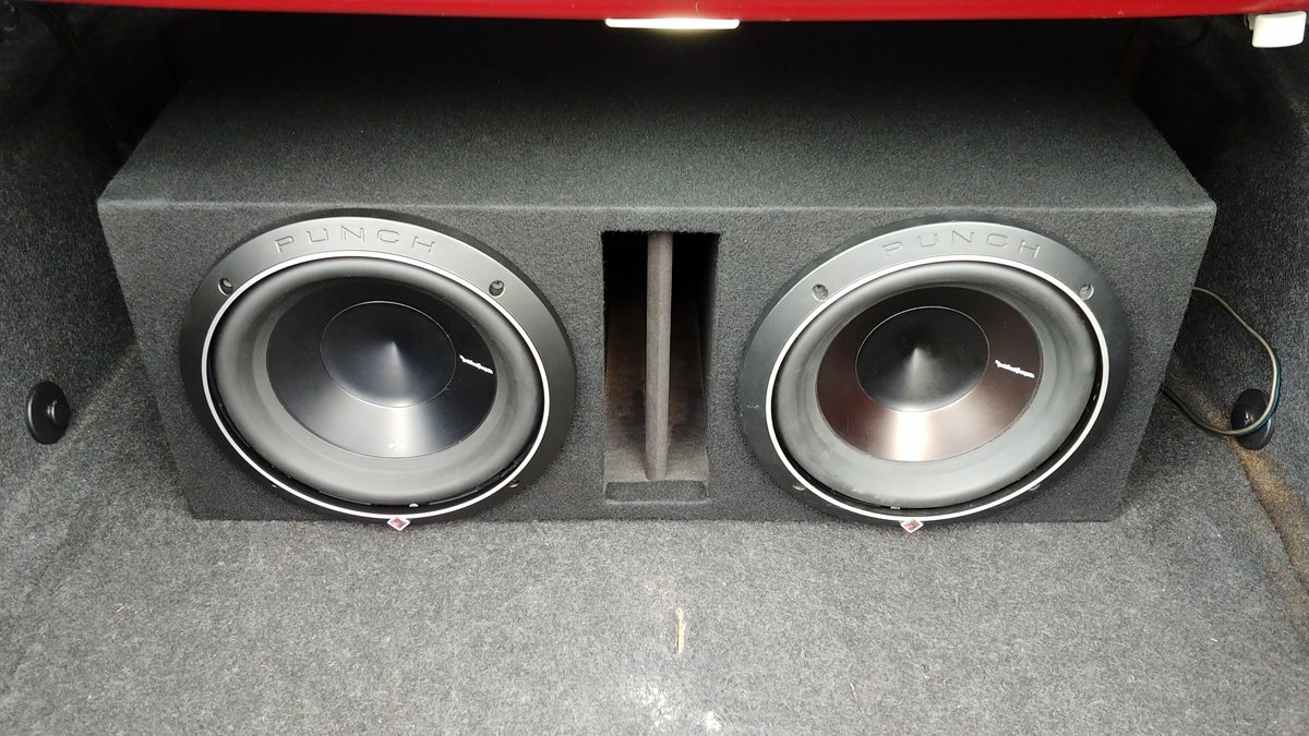

Current model P3's. They are that color because they have been very hot many times and cooled down many times. They have seen serious use another words. They are black anodized aluminum cones and dustcaps.
The pic is my pair. The right speaker is over a year older... notice the color difference.

No they were not painted by someone.
I think the official term they used was thermal anodized aluminum cone
There are just P3's but from 2014 give or take a year
600 watts RMS
D2 or D4 it should say on the back of the sub
The specs for an box will be the same as the the rest of the P3's from that time frame

Crap lol. Dang thats sucks you look at them and tell they been beat down. I would keep them but they are 2 different subs. A dvc2 and dvc4. Maybe that caused them to heat up. I wish i knew b4 i picked these up

One is a d4 and the other is a d2. I dont know how that happened. I got them from a co worker. Im not even sure what that would even work out to. 3 ohm maybe
