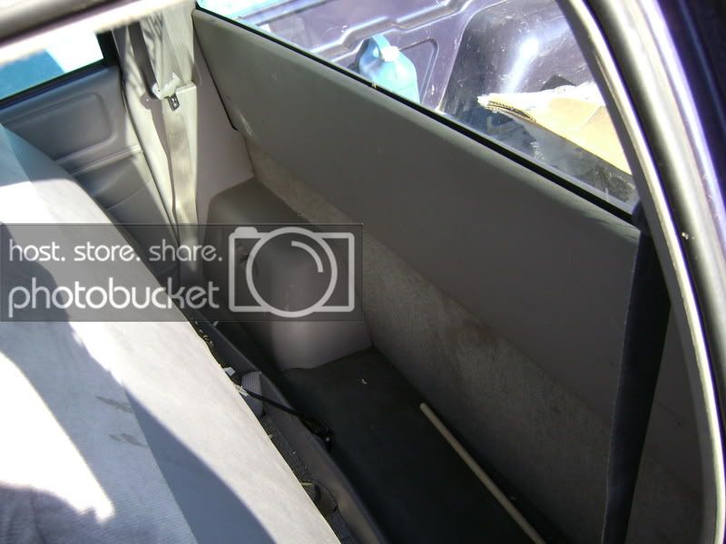

I won't be able to do a blowthrough in my 1994 Sonoma.
I've got space behind the seats right now thats:
8 1/4" wide
52" long
23" tall, or could go right to the ceiling.
What kind of enclosure would you guys run such a space?
What kind of subs could I use? I've been looking at shallow mount Pioneers,
I want the loudest subs I can get for my space.
I thinking, do a "wall" with shallow mount subs.
Would also like the enclosure to be ported.
I just got it so I gotta clean it out.

I have a std cab s-10, and I can cram about 2 cubes ported (using chimney-style ports) and an amp rack without going over the window line. Just move the seat up to the first notch before all-the-way-back. You have about 12" bottom depth, I think 12" height, and like 7" top depth. Do a ~25 sq in slot port on one side, and you should be at window height (you might have to extend the port a little into the box depending on tuning). 34 Hz tuning gives you around 24" port length, so you're looking at 1.75-2 cubes IIRC. This also allows a couple inches of clearance for excursion
If you just want to throw the amps under the seats, you can get a lot more room.

Well since my seat is busted and trashed, I'm gunna be installing two seats from a Cavalier/Sunfire.
Do you still have shallow mount woofers or are they "full size"?
Do you have any photos?

I almost had the same exact truck, a 96 reg cab sonoma, i had a rather large sealed box in there that I wouldnt suggest unless you are under 5'7".
I would suggest a box that is 52" wide, 22" tall, 4" top depth, 8" bottom depth. Run 4 10"s if you can, the cab will be very loud inside if you get over 1000rms on the 4 10"s.
Well since my seat is busted and trashed, I'm gunna be installing two seats from a Cavalier/Sunfire. Do you still have shallow mount woofers or are they "full size"?
Full size. With the wedge shape of the enclosure, I can fit about 7" of mounting depth.
