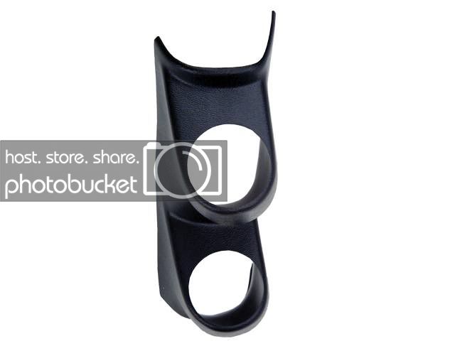

Hold up are you actually fiberglassing or adding on after marker parts?
its a 2 gauge pod i'm smoothing into my stock a-pillar...
edit...
a picture of what i'm thinking about...
no not that stuff, I use west system #105 and #205 or #206 depending on weather and temp. I also use the filler powders to create a filler thats far superior to bondo.
seems like pretty cool stuff... just use the resin with any hardner or powder and you make it do whatever you want...
