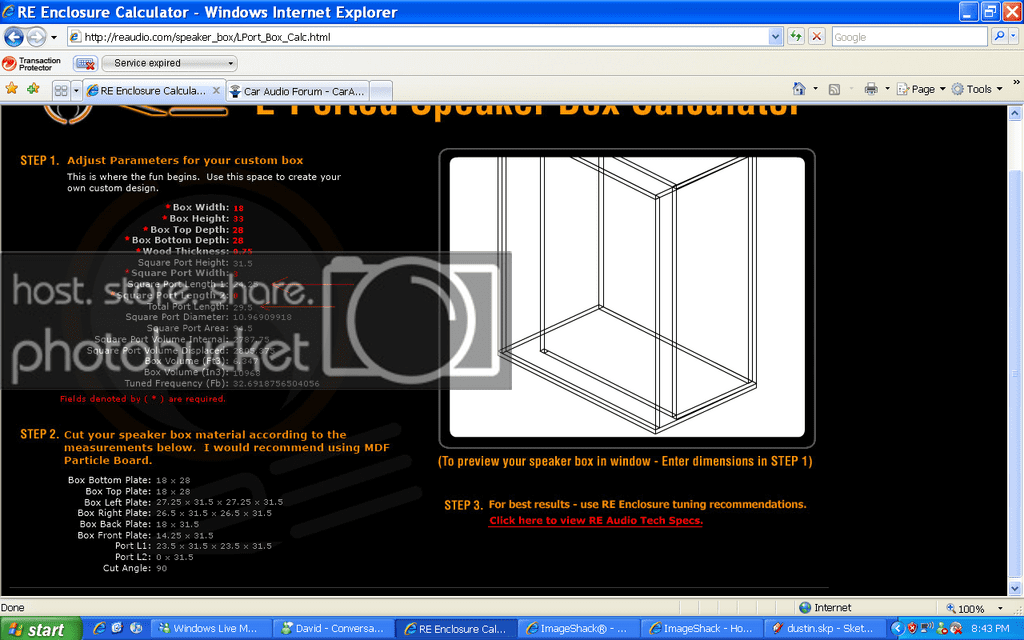

how are you figuring this up?
I used the RE calculator
You will notice that according to that picture the width is 18 and height is 33. Thats because I am going to be rotating the box in the vehicle where the subs are on top and port is facing the back towards the bottom. So they width is actually the height and the height is actually the width.
But according to it its tuned to 32 hz.
I don't use most of the online calculators so I'm not that familiar with them, but I see that you have port length 1 as 24.25" and total port length is 29.5" which is where you went wrong. //content.invisioncic.com/y282845/emoticons/smile.gif.1ebc41e1811405b213edfc4622c41e27.gif
-Bill-
-Bill-
where are you seeing this?
what program are you using? or are you doing it mathmetically?
If you want a 23.5" port then why are the arrows pointing to those numbers. //content.invisioncic.com/y282845/emoticons/wink.gif.608e3ea05f1a9f98611af0861652f8fb.gif I use LEAP, WinISD and pencil & paper.
-Bill-
-Bill-
you cant change those two numbers.
With that calculator, you have to use different box dimensions to change those numbers. Are you getting why I don't like using most of them, now? //content.invisioncic.com/y282845/emoticons/crap.gif.7f4dd41e3e9b23fbd170a1ee6f65cecc.gif
-Bill-
