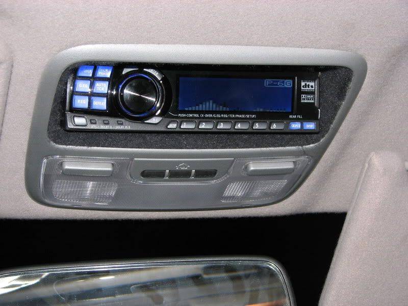

Alpine CDA-7930 in dash (RUX-C701 in sunglasses holder)
Alpine CHA-S624 in glove box
Alpine RUX-C701 in sunglass holder
