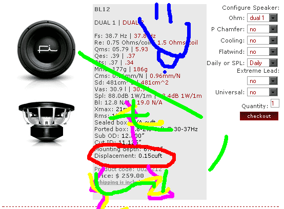

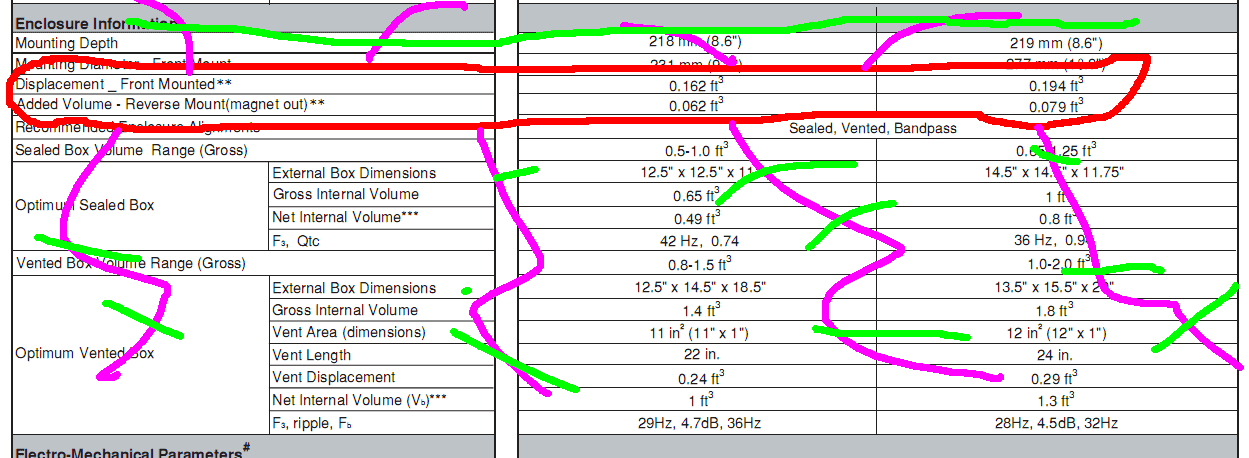

what is driver displacement?
To think....
It's not there so estimate based on other drivers of similar sizes. I would assume that sub would be between .08-.12 cubes. This is pretty insignificant and doesn't really need to be worried about. Subwoofertools just makes the enclosure slightly larger when you include driver displacement.
ok, thanx, thought i couldnt see it which is why i wanted to know about it, cheers again. on the subwoofer tools, i assume you can enter in your desired tuning frequency & it will calculate a box based on that if im correct ?, im trying to make the depth of my box smaller but can only get 21in max but ill figure around with it a bit more, im learning
