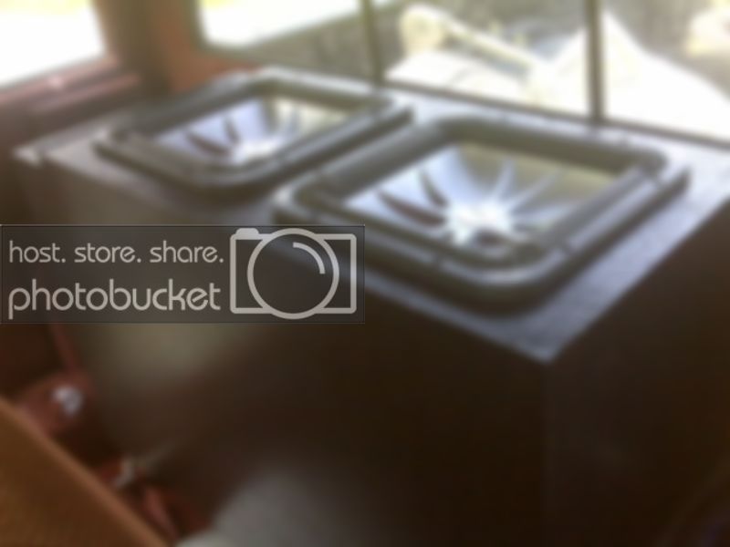

Here is a shot of the bed liner. I suggest getting the can not the spray but the roll can. I have heard it is easier and turns out better. Sorry for the bad pic I would give you another one but I sold that set up. I am getting ready to build another box for 1 15" and rhino line it, I'll post up pics when done. Granted the box does not look perfect but not to shabby for my first attempt

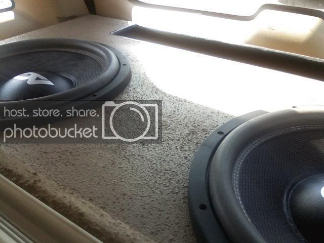

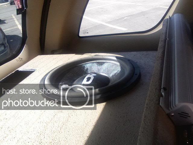

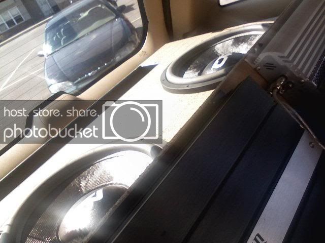

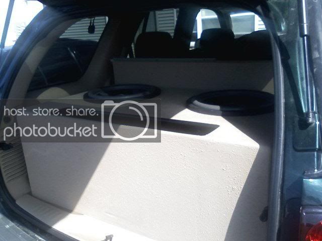

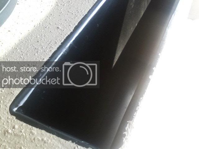

I got a gallon of color matched paint to my interior and than I mixed in some texture with it. Primed the box first, and the thing turned out badass...never seen anyone do it either before like it.
that bed liner is actually not a bad idea. Also I was thinking of doing a type of textured paint for my box (to match the interior plastics of my vw)
I built this box like two or three years ago and I still haven't put any finishing on it haha
I did a light sand job just to scuff up the wood. I didn't really take the time to make the box look perfect as I was impatient. I must also say I am terrible at cutting wood, and I used a skill saw. For the next box I am planning on using a table saw to make clean cuts, and have a better outcome. But still I was very happy,and so was the guy I sold the set up to.
heres some pics as I stated...used like 4 cans of spray primer....shot the port with black, and the rest is color matched paint with texture mixed in...amp rack was done the same way
