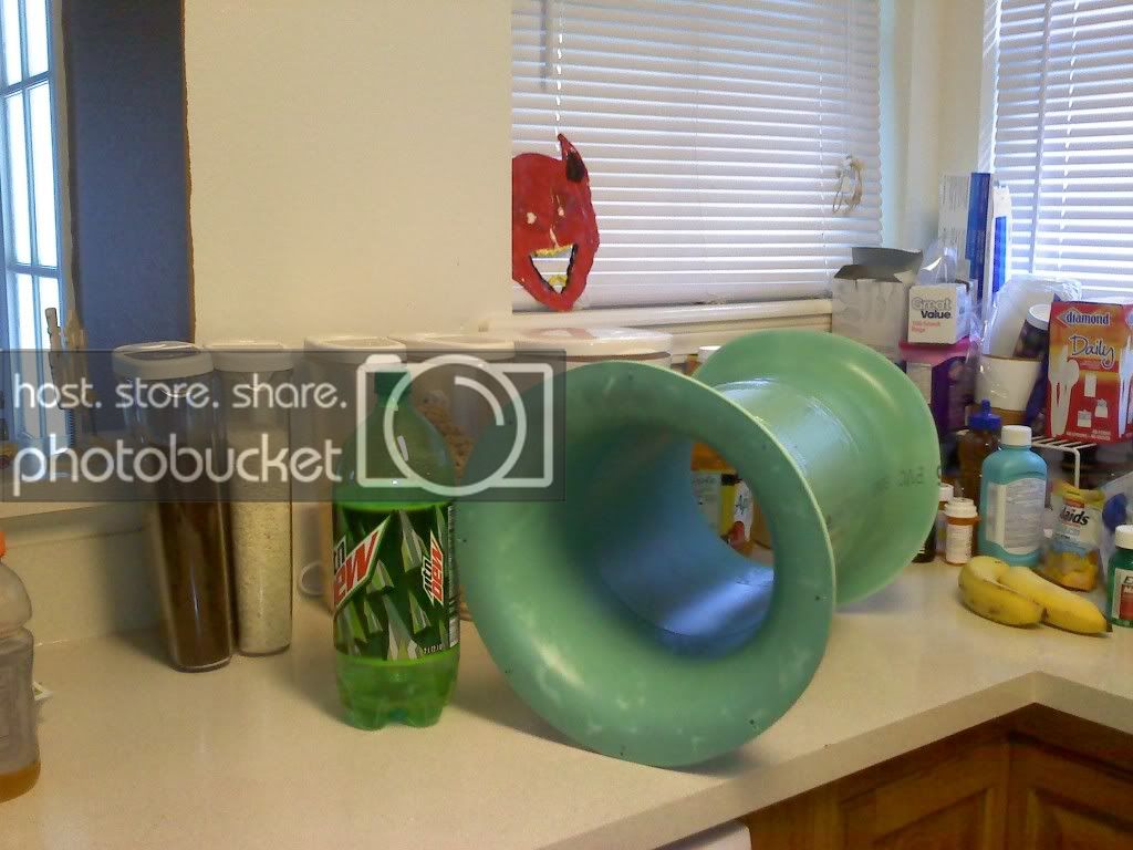

sonotube:
8" pvc:
6" pvc:

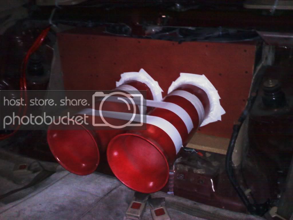

yes i made the 8" sonotube and the 6" flared ports in the pics...the one in the middle i got from amartin but he was banned awhile back.
