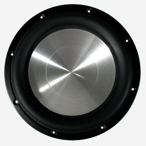

Since your amp does not produce much more power at 2 Ohms, I don't think it will make too much of a difference if you run 4 Ohms or 2 Ohms. Maybe just run two 4 Ohm subs to keep things a little cooler given this is a class A/B amp?
having said that....
I think 2 TC Sounds DB-500-S4 12" subs for $119 each shipped would be good choices with the power you have. Give them 1.2-1.5 cu ft per sub and stuff the enclosure with about 1.5lbs. per cu ft.
If they still have any left?
http://www.tcsounds.com/products.htm
Qts - .45
Qms - 6.35
Qes - .48
Fs - 24 Hz
Vas - 71.5 Liters
Xmax - 20 mm
Bl - 13.3
SPL - 86dB
Power - 400 watts
http://www.danmarx.org/blog/wp-content/uploads/2007/02/db-500_sub.jpg
