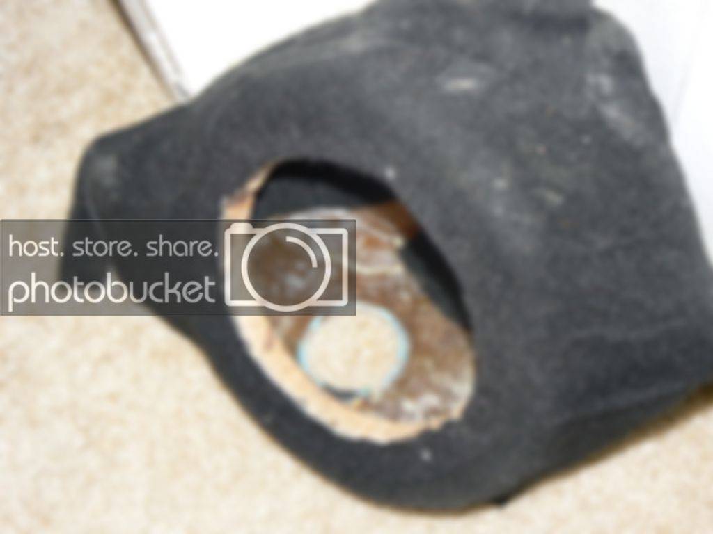

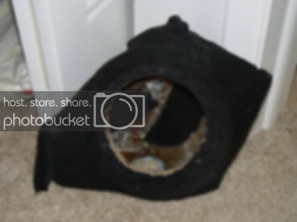

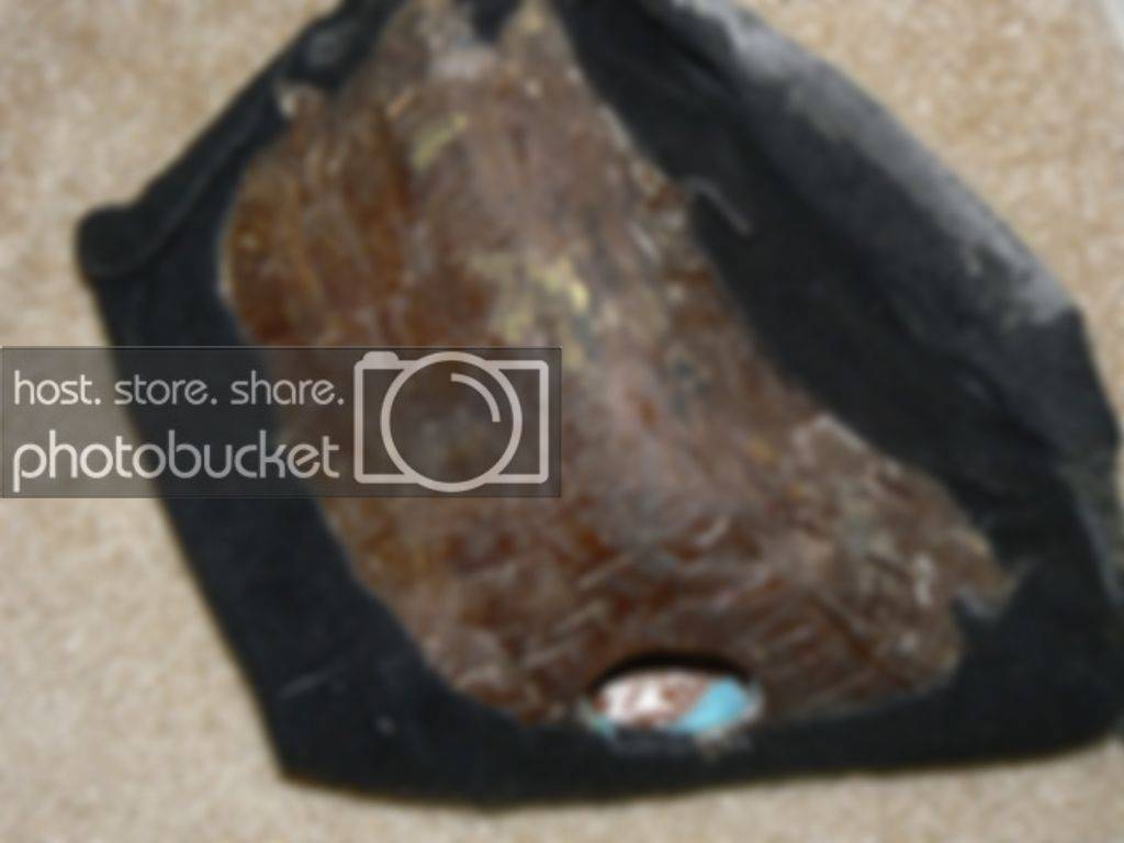

Each pod is 2 Liters (0.070629 ft³) before displacement, with a downward firing circular port. Port diameter is exactly 2in, and the port length (thickness of the fiberglass it's cut in) is exactly 1/4in.
I used this online calculator:
Subwoofer Vent Minimum Port Diameter Calculators - Maximum Air Volume, Number of Ports, Tuning Frequency
and did not get the answer I was looking for....
somone enlighten me
pics of aforementioned pod (which could use a lint roller cleaning)
blue stuff in the port is leftover foam that was glued into place making these pods sealed previously. i plan on cleaning that area off and possibly resealing the port depending on what info i get here.
Before you seal them up ever consider venting them into the a pillar cavity or some sort of cavity behind the kick panel metal? I have made pods alot like yours except mine at .2 cubic feet according to packing peanuts. I have hybrid imagines in them and they sound great, but when I had tried them in a cubic foot box with just a hole in the back for a vent they sounded 10x better. So ide consider venting them into the kick to give them more of an infinite baffle if thats what your speakers work best in.
