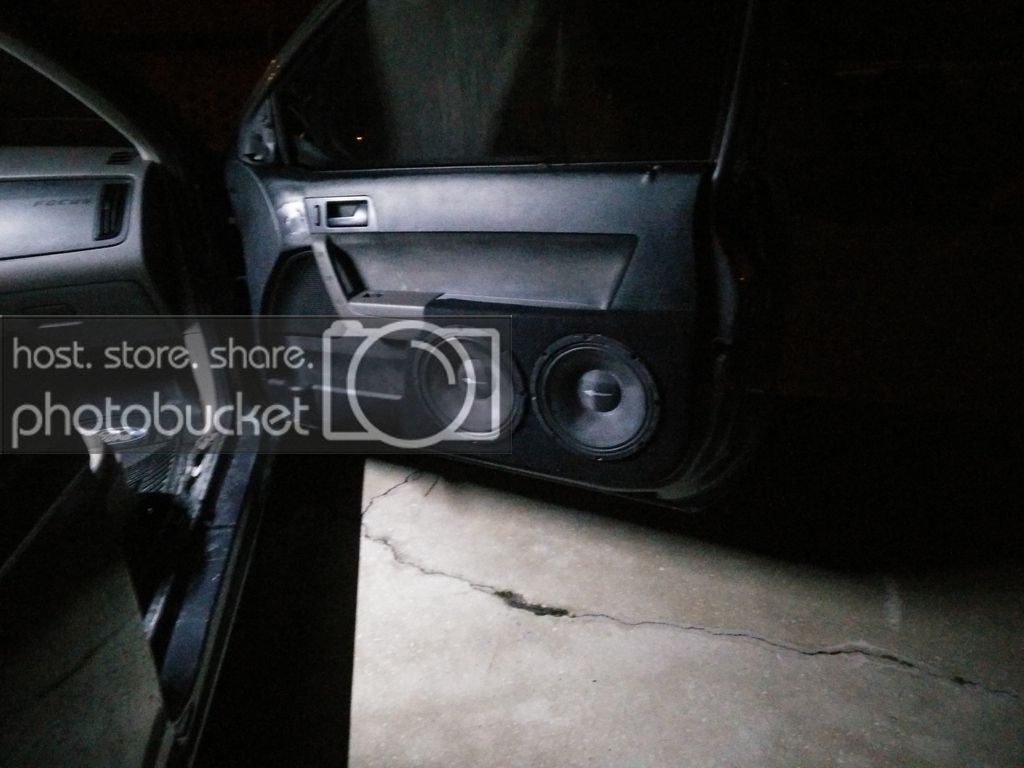

man doors are looking good.i like them amps also but wow they shut down with 15v ....
ya them tweeters look loud.. lol..
how do they sound ?
Yes Brazilian amps don't like 15+ volts. They makes their rated power at 12.6 volts.
My 10k is rated 10k at 12.6 volts. At 13.8 its rated 12,000 rms.
The horns are stupid loud. They are crossed at 2k and sound pretty good. Deff not an SQ setup horn. Just a stupid loud setup. Last show had a couple PRV demo vehicles and the Mclaren van. They were nasty.
PRV and Mclaren on two opposite sides of the huge field and playing with each other. It was amazing how loud they are with mid bass as well.

Almost done with the doors.

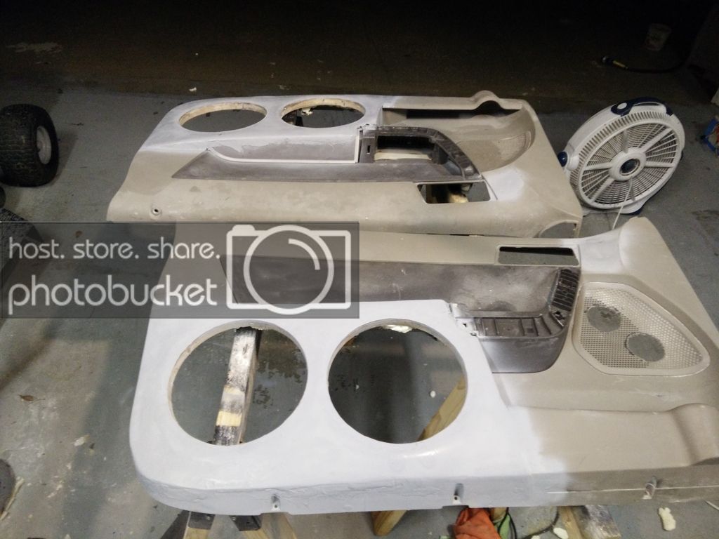

So ive been thinking about how you guys glass in speakers to pretty much float on your door panel(door card). unless you excessively deadened it, wouldnt your door panel rattle like crazy when they play. Also, does the magnets of the speaker stick into anything when you put the door panel back on?

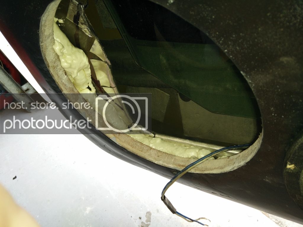

My doors have been fully deadened for years. If I need more I have more laying around. The magnets fit perfectly and don't hit anything. Made sure before glassing the doors.
The fiberglass made the panels super stiff and I have the backs spray foamed.
I don't think they will ever NOT rattle though. A wall on 10k is going to rattle lol

Ive never used fiberglass but from ive seen. The resin looks like it would add good weight to the panel. Can you show a pic of the back?

turned out well, i like it. id love to learn how to doors like that one day but it just seems like it takes so much time.
Thanks man. It was a good learning experience. Got frustrated a few times but I'm glad I did it. Looking forward to doing my trunk lid now.
