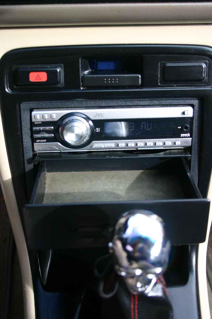

I plan to flush mount one, and would rather it be the small compact style like that so my mounting options would be muuuch wider. Any suggestions as far as where to look for something like that?
i've owned those type before. they aren't as small as you think once you get them mounted. they do work, but will fry the instant you wire them wrong.
