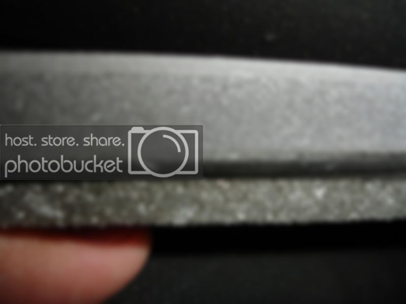

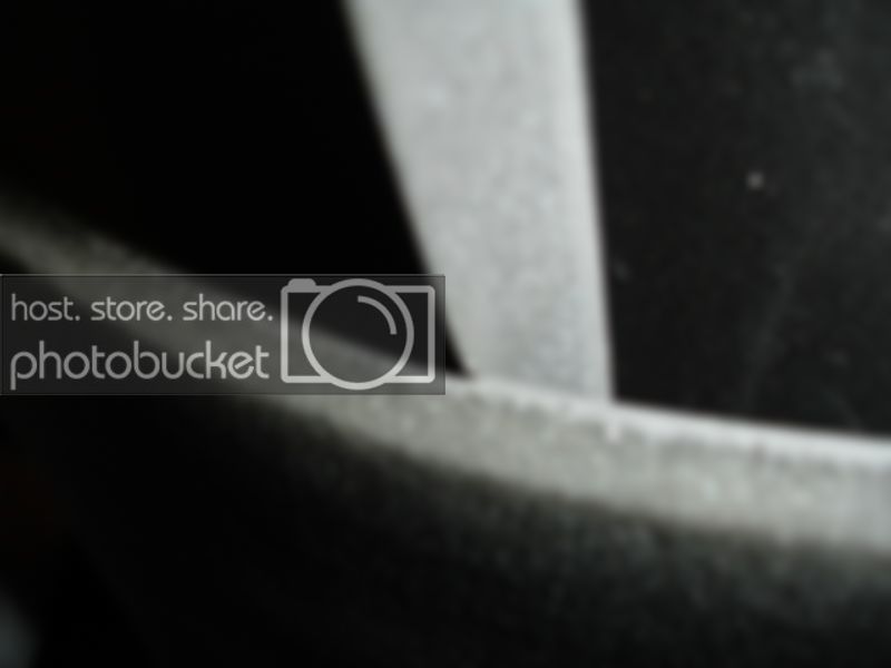

Here is a sample picture of a comparison between Second Skin LuxuryLiner and Vertex Barrier Pad (sorry for the blurry pics //content.invisioncic.com/y282845/emoticons/blush.gif.99bc659ee2012b7d826165e26fb5eebe.gif):
Vertex on top, Second Skin on bottom
Vertex is vertical, Second Skin is horizontal
