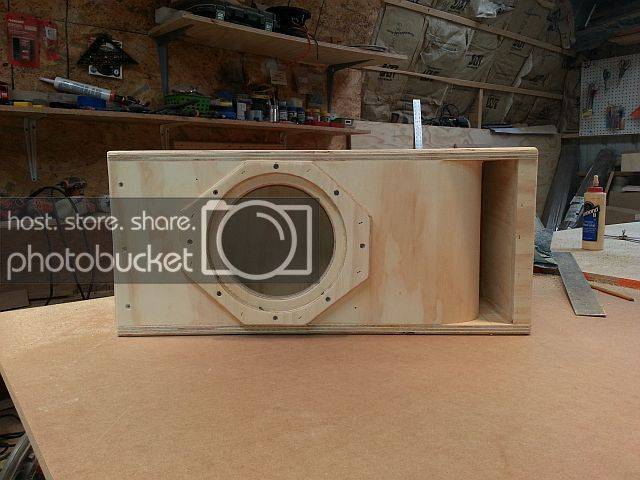

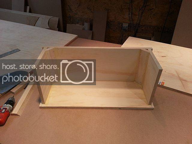

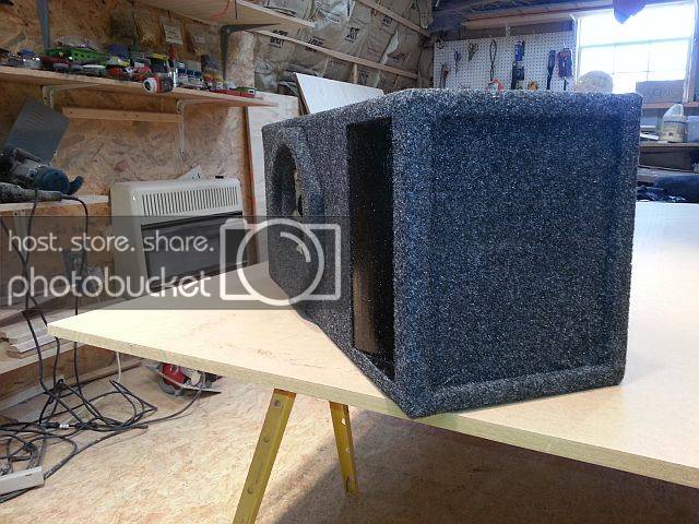

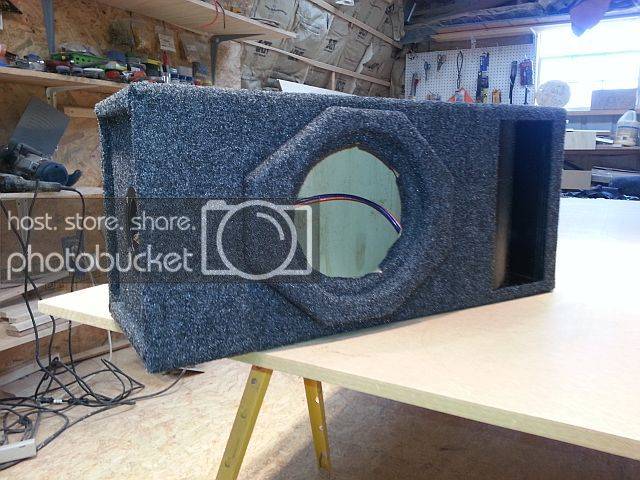

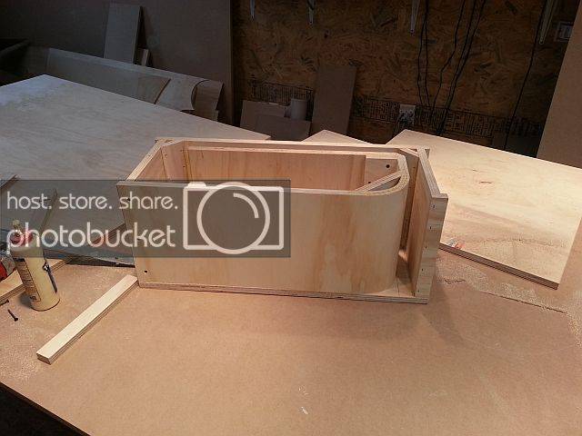

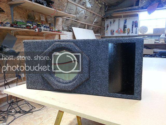

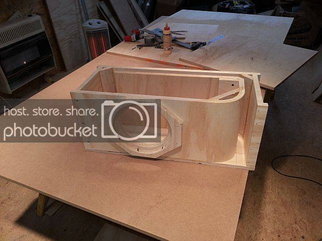

Single SA 8" V2 in .75cf net @ 34hz........Flush mounted sub...Arauco construction....kerf port....
