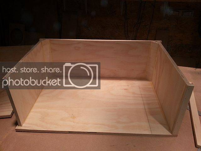

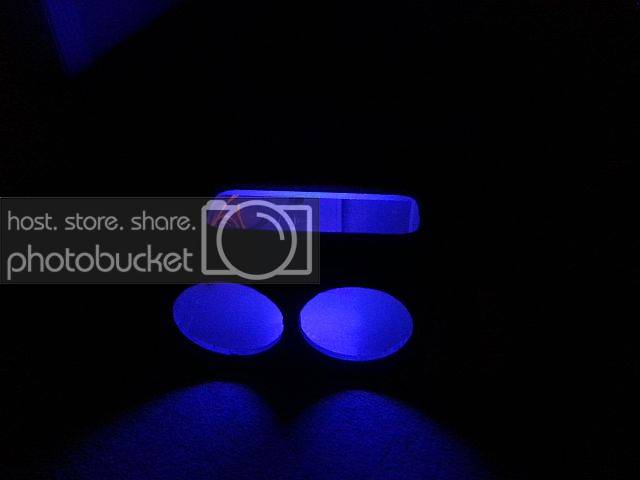

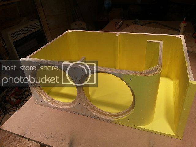

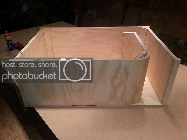

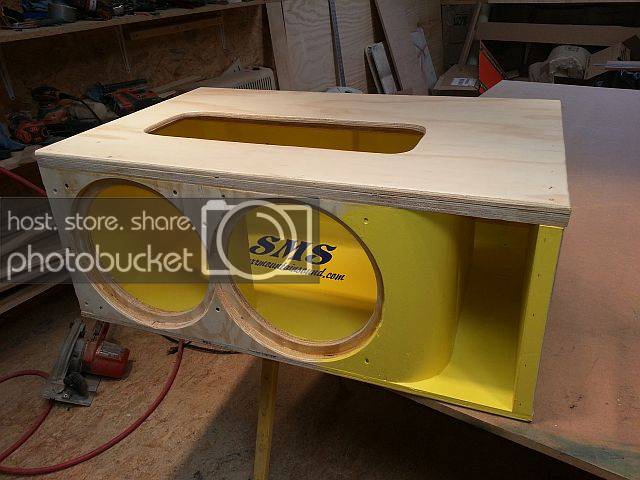

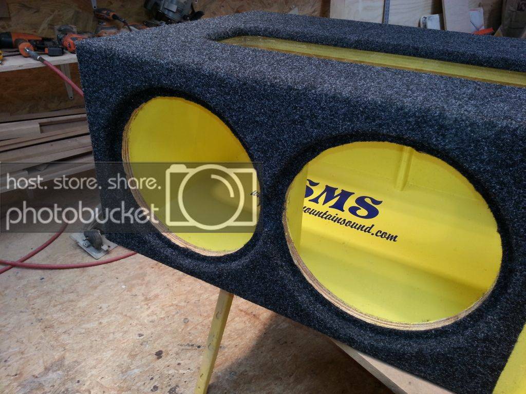

Pair of OA 12s.....4 cubes net 32hz......kerf port....charcoal carpet.....yellow accents..plexi window over sub motors......Arauco constructed
Nice work as always.Cant wait to get one built for myself...//content.invisioncic.com/y282845/emoticons/fro.gif.c695f1f814b01c4ad99fe7f8cccadd29.gif
