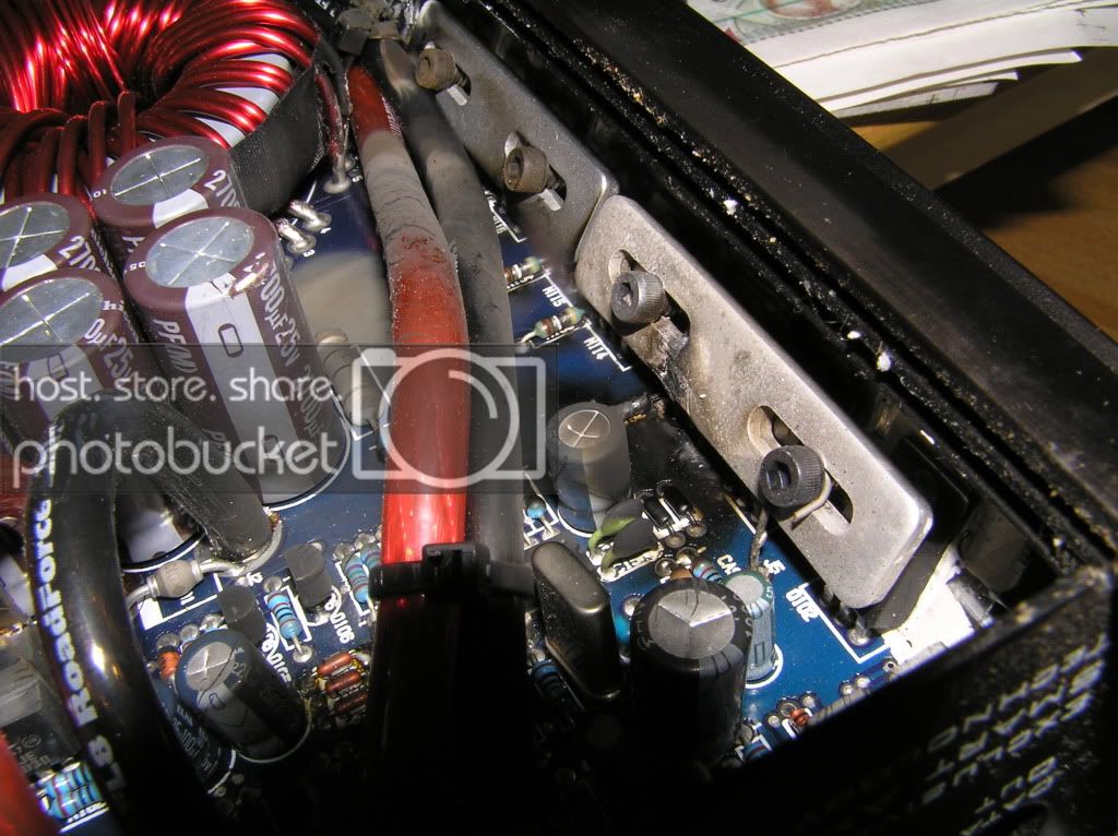

Has been flawless for over 1.5 yrs till the other day it shut off at low volume level. I only had the car on for 10 min aswell And then the car turned into a BBQ....What in the world happend? Is this fixable? Guess im going to have to talk to Greg I am assuming?//content.invisioncic.com/y282845/emoticons/crap.gif.7f4dd41e3e9b23fbd170a1ee6f65cecc.gif

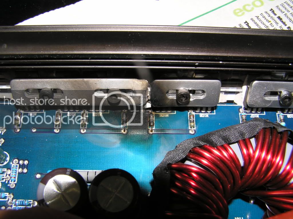

These are all the same MOSFET on one side closest to the power imputs

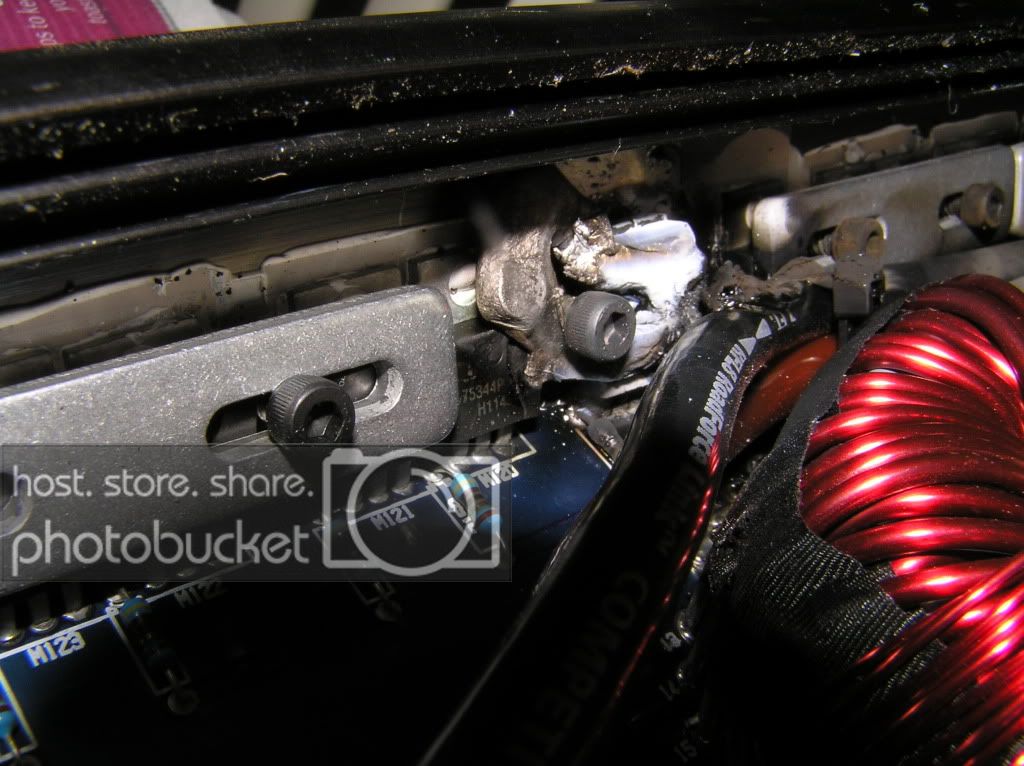

This is on the other side halfway on the board

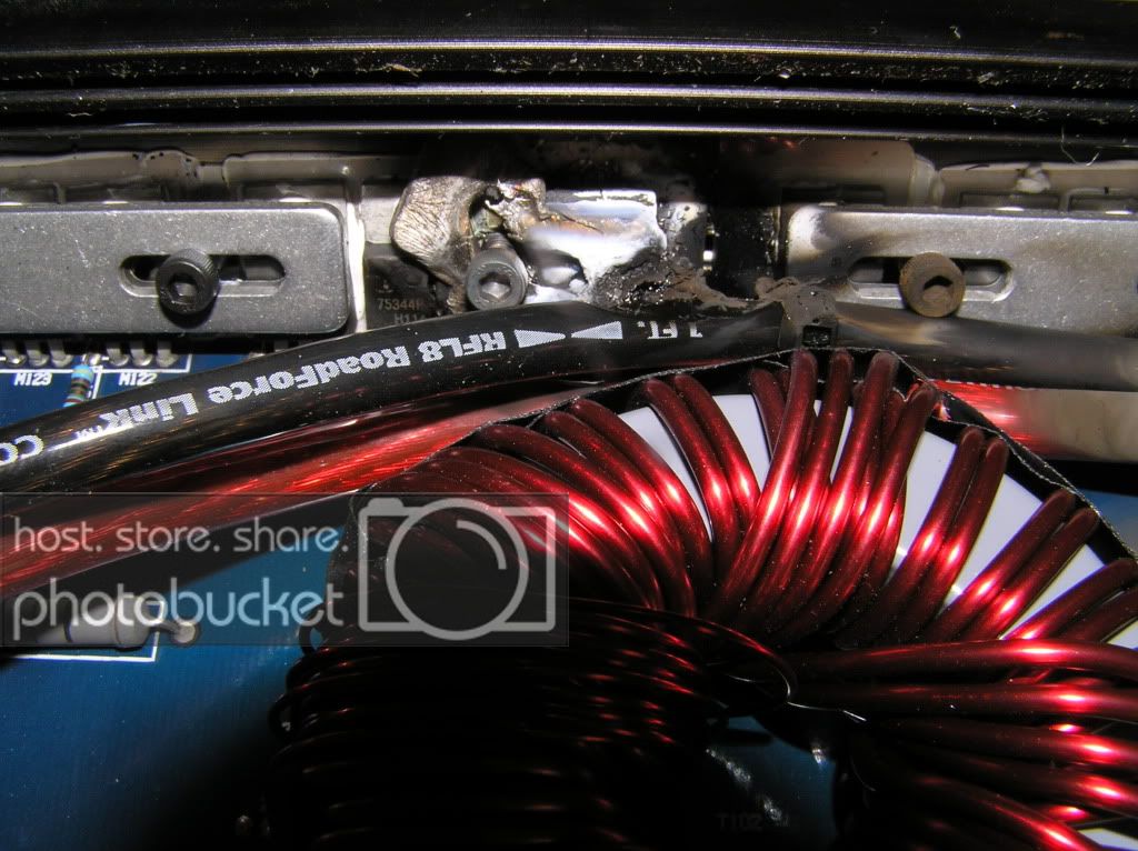

Looks like that black wire is your problem.... got stripped and shorted. Probably from vibrations. Did you mount this on the box?
uhh.. i don't think so. the jacket on 8ga doesn't just "strip from vibrations"..
that looks like it happened during the BBQ.
I initially thought the same thing but definitely appears it was roasted and not the cause. The wire tie looks to be somewhat intact to where it was attached. An no I have it on a amp rack separate from the box.

Why would it cook right there next to the clips, where it is closest then? Blowing rail transistors will not cause that heavy guage wire to melt, however that wire shorting out will cause transistors to blow.
then it's likely that the heat on the OUTside of the wire caused it to melt FROM the outside.
not "strip".
