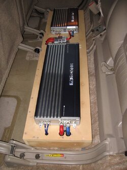

Decided to replace my amps for smaller/higher power options, just have a few questions. I will be running factory electrical.
1. Is 136w considered ample power for mids and highs? I can also get an alternate Taramps amp for nearly double the price that would do 4x192W RMS
2. Since these amps are both way over the speakers rated RMS, I will run them with the gains super low. Would setting gains with a multi-meter be ideal? Or inch up until I hear distortion and back down? Any pointers is appreciated.
3. Will I be ok from an electrical/voltage perspective?
4. Do you guys think this is worthwhile from a sound quality/bass output perspective?
Sub:
Current: 2014 Soundstream Rubicon RUB1.1000D running at 1 ohm 1000w x 1
Replacement: Taramps HD 3000 to run at 1 ohm 3000w x 1
Sub = Sundown Audio SA12-D2 wired to 1 ohm in a sealed box
Mids/Highs:
Current: 2014 Soundstream Rubicon RUB4.500D running at 4 ohm 75w x 4 RMS
Replacement: Taramps DS 800x4 to run at 4 ohm 136w x 4
Mids = Dayton Audio RS180-4 7" 4 ohm, rated at 60w RMS
Highs = Dayton Audio RS75-4 3" 4 ohm, rated at 15w RMS
you'll be fine with the ds 800x4 since its rated at 12.6 volts you'll be having closer to 150-160ish watts if you keep 14.0 volts.  You wont really hear distortion but you'll hear peaks in the frequency response when the tweeter/mid starts getting stressed.  You never ever want to use test tones for mids and highs.

You will be fine. Speakers are all rated at full range for rms number. Once you high pass them at an appropriate level it raises the rms substantially.
Ok that helps, my tweeters are technically full range so that explains why the rating is so low, i think my mid speakers are too. I guess the same rule applies to my mid speakers except not as much of a buffer as if i was using them for highs.
The RMS rating used for full range is low but once you put a crossover onto them, the power handling shoots up dramatically when you limit the range.  Thats why some rare few manufacturers actually list power handling at different crossover points.  Hell even my stock sienna speakers thrown on a ppi 900.4 took every bit of it once i threw a high pass on them.
